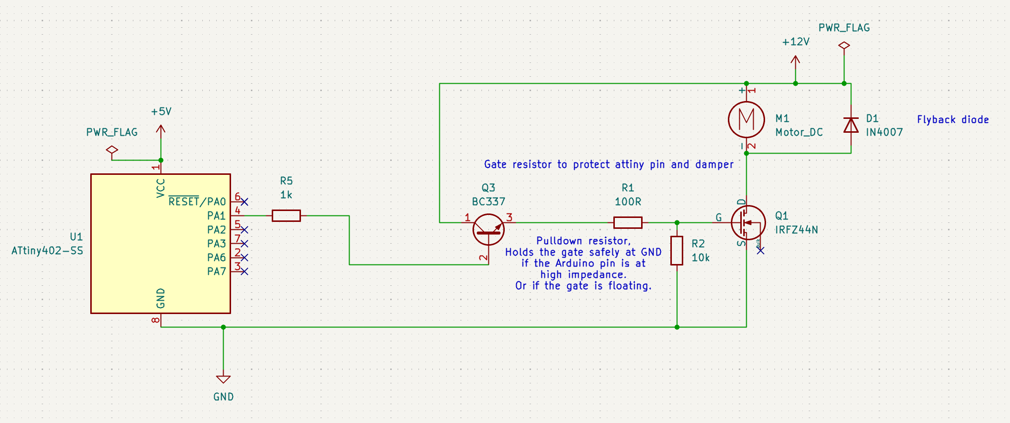

I would like to drive a R385 pump ( R385 Water pump - 6-12V buy cheap online | Funduinoshop ) with a microcontroller and I would like to get some advice if I am doing it the right way.
This is my current schematic:
I later would like to replace the IRFZ44N with an IRLZ44N or with an IRLML2502 to drive the MOSFET directly with the Attiny402. ( They are still in the mail so it will take some time.)
Does the circuit and the comments make sense or did I missunderstand something?
I did not power up the system so far since I am not sure if I might damage something.
Should I add a capacitor at the attiny to stabilize the power supply?
Do I need the 100R if I use a transistor or do I only need that if I drive a mosfet directly with a microcontorller?
(If needed I also can post the code which I use to generate the signal)
Many thanks in advance.
Using an N channel MOSFET as a high side switch seems an odd choice to me. What's the reasoning behind that?
The IRLZ44N is a good choice of an N chan logic level MOSFET, but it is a Low side driver and does not need Q3. Everything else looks good.

Good to know, the idea was to drive the IRLZ44N directly with the microcontroller and a 100R resistor. (The transistor just added so the IRFZ44N would also work). Sadly I still need to wait until it gets delivered. At the moment I am stuck with the IRFZ44N and a box transistors :sweat_smile:
Yes, the IRFZ44N requires 10V to be fully on so needs the transistor but the IRLZ44N only requires 4.5VDC so can be connected to a 5V logic pin.
HOWEVER both are N chan therefore are used in what is called a LOW SIDE driver. Here is a proper schematic for both LOW side and High side.

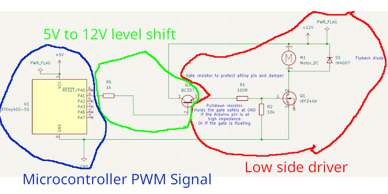

I updated it like this now. Does it now look better? It seems that low side drivers are better for motors at least some one wrote that
Maybe I should explain why I did it like this so I know were my error is.
Blue: I first use the microcontroller to generate a pwm signal.
Green: Then the transistor is used to shift the voltage above 10V . (only for the IRFZ44N)
Red: With this voltage I am able to satuarte the mosfet (IRFZ44N) to control the motor/pump.

I think you need to learn how MOSFETS work. Then the reason for why/how a Low Side driver using ONLY an N channel MOSFET is done that way.
Right now you are just following the breadcrumbs and taking advice from unknown internet sources that may know nothing. I am attaching a fairly good tutorial beginning on page 9. I hope this helps.

Wrong. The emitter of that transistor is always 0.7volt lower than it's base.
So 4.3volt max, and even lower because of some volt drop across the base resistor.
Study this page.
Leo..
Not better but usually requires less components.
If you use an IRLZ44N you won't need any level shifting
Aren´t mosfets like electrical switches and depening on the type you got p/n it acts alittle bit different. A n channel blocks the flow if there is no voltage at the gate but if I put a voltage at the gate and it is bigger or equal the threashold voltage then the mosfet let it flow? And the p channel does mirror that behavior with reversed polarities? Thats how they are currently working in my head.

Voltage is always relative to an other point.
A fet turns on (starts to) when the voltage between gate and source is higher than it's threshold voltage. Same for N and P-channel, only different polarity.
At the threshold voltage only an insignificant current flows. you can see threshold voltage as a turn-off point.
Above that voltage, the fet acts as a resistor( getting hot with current flow).
Vgs must be significantly higher for the switch to act as a true (low resistance) switch.
That resistance Rds(on) at certain Vgs can be found iin a graph in the datasheet.
