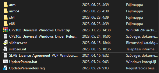

Honorable mention: This was going on with my main PC as well, but I found a USB to UART driver called CP210_Universal_Windows_Driver and it fixed the issue. The problem is, I cannot install this same driver to my NoteBook for whatever reason, maybe cause my main is Win 10, and my NoteBook is Win 11.
