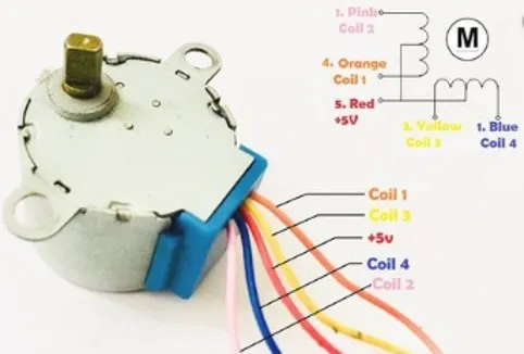

@madmark2150 for the pinouts I referenced this video and specs
from that 28byj-48 pinout should be
Blue Coil 1A
Yellow Coil 1B
Pink Coil 2A
Orange Coil 2B
I checked and I have 45ohm resistance between yellow and blue and between pink and orange.

The stepper you are using has five wires and is called a unipolar stepper.
You are trying to use it like a bipolar motor, here is a very interesting link;
28BYJ-48-5V-Stepper-Motor-pinout
You do no have two separate isolated coils as in a bipolar stepper, but 4 coils connected to a common point.
@TomGeorge hey if by the common point you mean the red wire than as mentioned i have cut the trace that led to the red wire and desolder it from the motor.
I checked the resistance and only pairs blue + yellow and orange + pink has now the resistance as per video below:
So you now have a stepper with two isolated windings.
