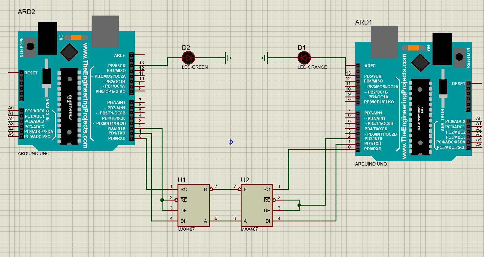

Hi, @Lesthegringo
Can you please post a schematic of your network?

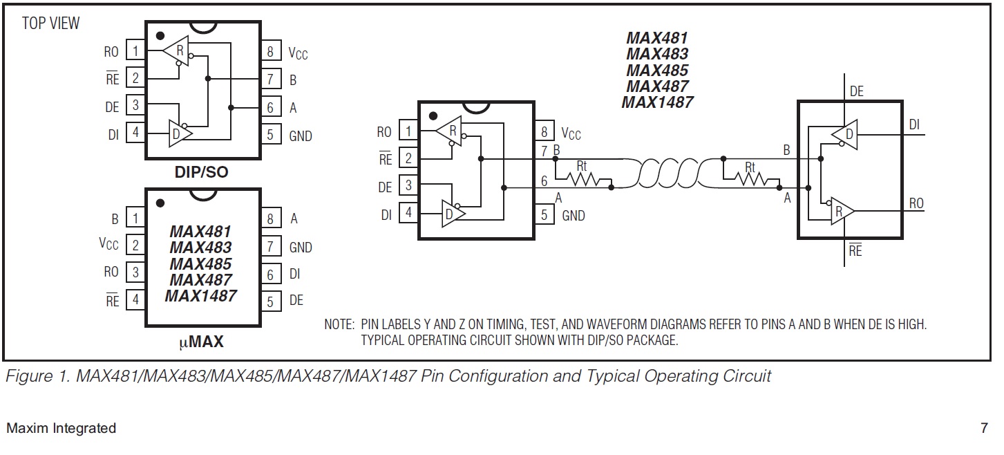

You do have the terminating resistors connected at each end of the 485 bus?
Thanks for the replies
The RS485 slave is via a max487 chip on a custom made shield for the Mega, hard wired to the LED panel; the master is another Mega with a custom RS485 shield with a MAX487 chip hard wired

Errr, no - the requirement for resistors has never appeared in any schematic that I have seen for using RS485 with Arduinos; that's not to say that they shouldn't be there, just that it has never appeared as a requirement
For interest's sake at least, why would they be required? It would be simple enough to try it basically I have the setup like this except that the arduino D2 pins go to joined RE and DE pins on the max chips

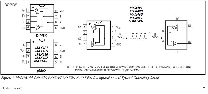

Page 7 of MAXIM datasheet.
The reason for the resistors is that the 485 bus is a current bus.
If the examples you saw were breakout modules, the resistors would have already been fitted and had jumpers to switch them in and out.
Like I said, it looks pretty easy to incorporate
I have just grabbed an RS485 module from my stocks, and put an ohmmeter across the A and B pins - 120 ohm is what I measure, although I don't know what the internal resistance of the Max chip is
I can certainly add a resistor between the pins, what value would be correct?

Can you post the code for the mega that is controlling the rs485 bus?
Is the rs485 bus connected to multiple boards, or just between the two mega boards?
