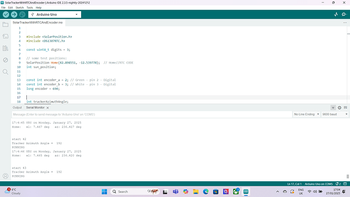

I've tried this now and still doesn't work.
Please see picture of serial monitor running. I've sent 5 to show the encoder changing position as I rotate it.
You have still not posted code that will work on the Arduino Uno.
Anyone can get code to compile by using the correct syntax. But just because code can compile it doesn't mean it will do what you expect it to do.
I pointed out in my post#24 some big mistakes you have made with your code.
The screen shots are less than useless, posts in image form are always useless unless you want to show pictures of your wiring or schematics.
If you want to post what came out of your serial port, then copy it and treat it like you are posting code.
