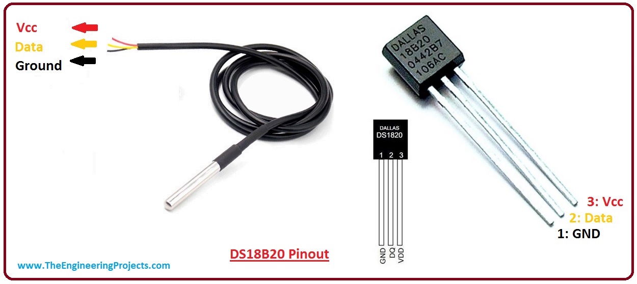

I connected the ds18b20 sensor with arduino as in the picture.

Usually, a 4.7K ohm 1/4W pull-up resistor is used with DS18B20. I can see that you are using a 5W resistor. Perhaps that is not an issue. But it's better to try the typical circuit. I do not think the problem exists in the code.
Looks like you are assuming the red wire is +, black is - and yellow is signal, that may NOT be the case. That's why I posted reply #8
yes, i assume so.

Post us some images with the 18B20 in the frame.
Certain these are correct...???

hello tomZ pic is attached:) and i have learned arduino 4fast-4Slow red blinks when MbedOs crashes.
as i said earlier when i upluad the code without connecting ds18b20 sensor; it also crashes.
thanx for your kindly reply:)
#include <OneWire.h>
are you sure that the libraries are compatible with Giga board?
no i am not sure. how can i check or verify please?
