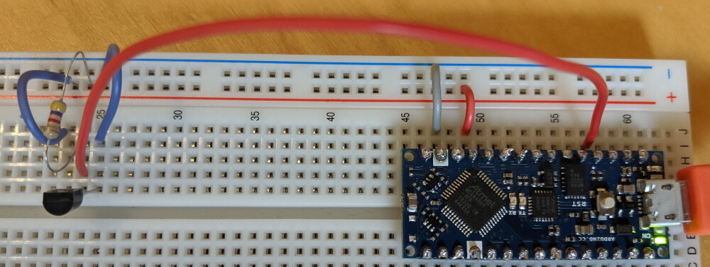

I am in the exact same situation, although I first created the circuit using an Arduino UNO Rev3.
I upgraded to the the latest version as you said (2.3.5) and it still does not work...
I think I might be confused with the pinout, I find it a bit confusing.
So the code states this:
// Data wire is plugged into pin 2 on the Arduino
#define ONE_WIRE_BUS A0
So I see 2 different information:
  • pin 2
  • A0
Could someone clarify which physical pin is being used here?
To be honest I'm very new in the Arduino world...
georgeslegros:
- pin 2
- A0
This comment:
has absolutely no effect on the code. It's unfortunately quite common to find code where the program was changed (e.g., switching from pin 2 to pin A0), but the comment was not updated.
The correct pin is definitely A0.
All right, thanks for the clarification.
Now, it still does not work... What can I give you that will allow one to see where I'm being stupid?
Here is the code I'm using now (after lots of simplifications like removing the interrupt I was using before):
#include <OneWire.h>
OneWire oneWire(ONE_WIRE_BUS);
  // Start up the library
 sensors.begin();
  Serial.print("Requesting temperatures...");
  sensors.requestTemperatures();
  Serial.println("DONE");
  Serial.print("Temperature is: ");
  Serial.println(sensors.getTempCByIndex(0));
  Serial.println("");
I'm using OneWire 2.3.5 as you can see in the attachments as well as a photo of the actual hardware.
If someone finds where I made a mistake, that'd be awesome...
