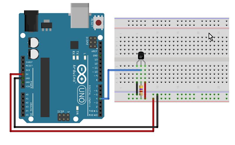

I'm running the circuit and sketch from this tutorial, which uses the DS18B20 thermistor:
My circuit is the 'normal' option, reproduced below.
But I'm wondering about the accuracy of the result. My commercial unit that I believe accurate says 19.4 versus 24.1 from the Arduino citcuit. Both probes are suspended and are a mere inch apart.
20:50:58.635 -> Celsius temperature: 24.12 - Fahrenheit temperature: 75.43
20:51:00.417 -> Celsius temperature: 24.12 - Fahrenheit temperature: 75.43
20:51:02.148 -> Celsius temperature: 24.12 - Fahrenheit temperature: 75.43
I'm using identical code, reproduced below.
The only differences I can think of are:
  • I assume a Vcc of 5.0 is used; mine (via USB) is 4.86.
  • I had no 4k7 resistor at hand so used 5K1.
Assuming both of those cause a linear reduction would combine to give a result of 21.7, 2.3 below the program's output.
Comments appreciated, especially from anyone with experience of similar circuits please.

Is the offset between the different devices constant?
Have you left the sensors stationary in still air long enough for temperatures to stabilize after handling? Say 15 minutes?
How far apart are they?
From the DS18B20 datasheet:
  • Power supply between 3.0V and 5.5V
  • "The 1-Wire bus requires an external pullup resistor of approximately 5kΩ"
that's ok
Where did you buy your DS18B20? There are lots of "counterfeits" floating around on E-Bay, Ally, Amazon, etc. While not really counterfeit, they may be "rejects" kicked out by the manufacturing QC equipment for being out of spec (+/-0.5°), then bought in bulk and resold as "genuine" by unscrupulous sellers.
Yes, half an hour of observation.

Did you try another DS18B20?
I mean, if the commercial device reads 20 degrees, does yours read 18, and if the commercial reads 25, does yours read 23?
(And so on)

Thanks, understood. I will test over a larger range tomorrow and see how the difference varies, ( I thought perhaps by ‘offset’ you were referring to circuitry voltages.)
At around 21:00 in the late evening the room was cooling down a little, but still perfectly comfortable. Tomorrow I’ll experiment with:
  • alternative probes from the same purchased batch
  • ice cubes in water
  • boiled water
  • one of my DMMs, which has a temperature option
Thanks, interesting and I will. But I haven’t a clue how to perform this ‘pathetically simple’ test!
Regarding (II), there is one pathetically simple test for differences with Maxim-produced DS18B20 sensors that apparently all counterfeit sensors fail [5]:
  • It is a fake if its ROM address does not follow the pattern 28-xx-xx-xx-xx-00-00-xx [5]. (Maxim's ROM is essentially a 48-bit counter with the most significant bits still at 0 [5].) Also, with the exception of rare Family A2 and Family E, none of the fake sensors adjust reserved byte 6 in the scratchpad register correctly. Only the fake sensors of Family A2 respond correctly to undocumented function codes regarding the Trim values.
