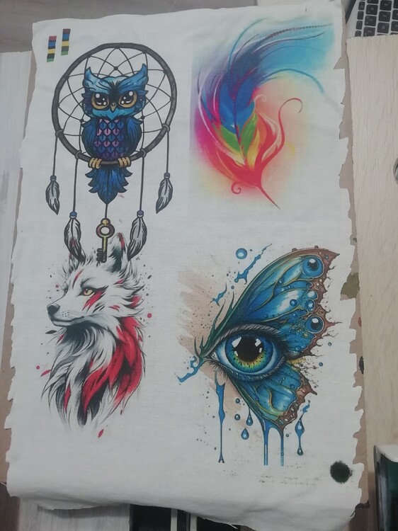

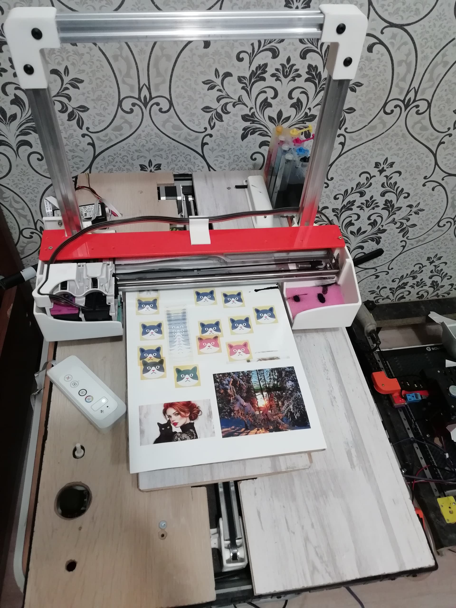

DTG prototype. flatbed printer. assembled a stand. added two buttons on the Y axis and a limit.

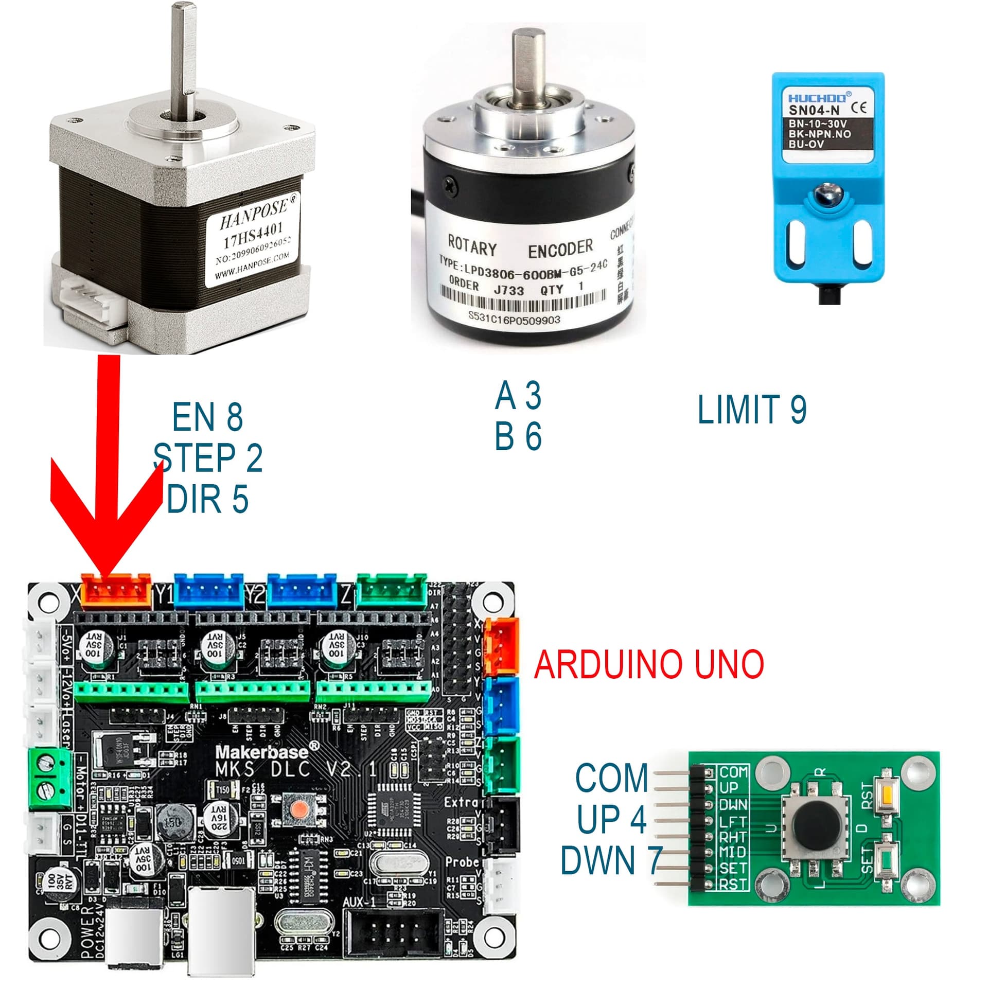

Need help!!!!!!!!!!! In writing code with 600 pr optical rotary encoder and nema17 stepper motor. for transmitting a signal from an optical rotary encoder to a stepper motor, taking into account the regulation of speed steps for synchronization

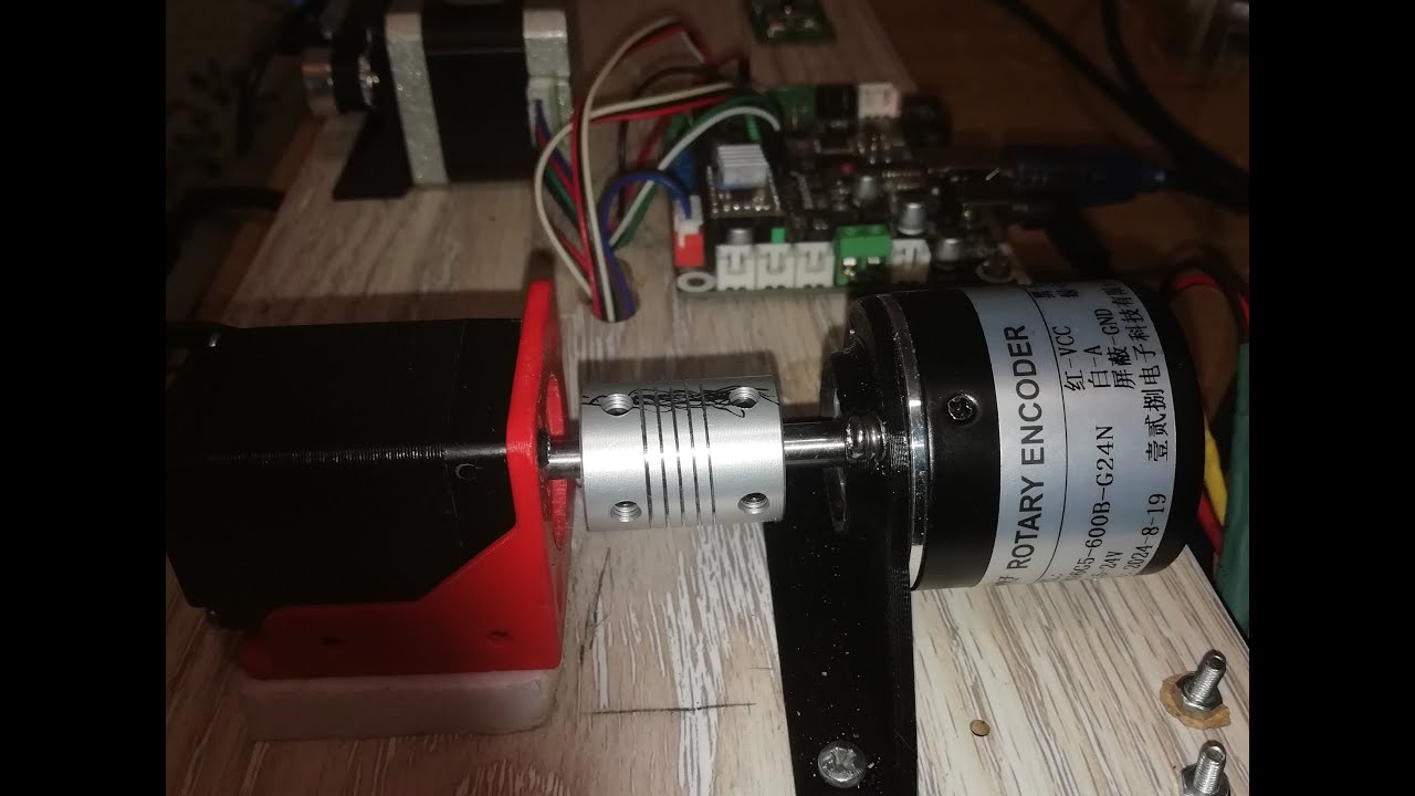

now nema 8 turns the rotary optical encoder 600 pw at a speed of 16000 mm min, probably like a printer engine turns
I tried 2 codes below and there is a video for them as the encoder copes with them with a bang.
Tell me how to further attach the stepper motor to this en code. step. dir, with adjustment of the number of steps in the sketch itself.

I wrote everything in one code.
everything works but the code for the motor does not work correctly
it must take one step from every 3 ticks of the encoder, but it works like this on + or - of the encoder, the signal got there and. turns the engine while all the buttons and limit switch remain operational
I need to fix the code here
from 126 to 166 line
there I did it both by timer and by steps, the result does not change
code yes, I think a simplified version should work like this
