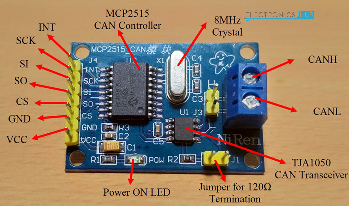

I need to connect two can buses to the arduino, but I also need to save space on the board.
At the moment I have connected two MCP2515 and two MCP2551. Both MCP2515 requires crystal oscillator, but I noticed that they have CLKOUT pin, so if I understand correctly I can use only one crystal oscillator for only one MCP2515 and then use it's CLKOUT pin as an oscillator to another MCP2515 CLK1/CLK2 pin. Would it work?

I actually don't wanna use any other board/dongle, because I am making my own one. What I want is some kind standalone MCU that has two can bus controllers. Arduino DUE standalone MCU (AT91SAM3X8E) would be an overkill for my project. I need something smaller like a 32 tqfp/ssop package, but I guess there's no such MCU, so I guess I'll be good with Atmega 328 MCU and a couple of MCP2515 & MCP2551.
So there's left one question that I asked in my first post. I looked at MCP2515 datasheet and it says that CLKOUT can be configured to act as clock out pin and OSC1 is marked as an input pin. So if I connect only one crystal oscillator to one MCP2515, then connect it's CLKOUT pin to another MCP2515's OSC1 pin, it should work, right?
That's what I'm using at the moment. I have 2 of these modules connected to the Arduino Uno, but since I need to move everything onto single pcb, I need to use as less space as possible. That's why I want to know if I can use only one crystal oscillator for 2 MCP2515's, since 2 of them would use more space.
The crystal is not the oscillator, the oscillator is inside the 2515, so it will not be possible to share one crystal between two 2515s.

I might misunderstand about crystals and oscillators because I never made such things, only been using chinese modules. I found a topic about 2 MCP2515's and a single crystal: Two MCP2515 one crystal, how to set CLKOUT - Networking, Protocols, and Devices - Arduino Forum and after reading it, I have a clear answer to my question, but now another question came to my mind. Would it be possible to use one 16MHz crystal for Atmega328 MCU and use it's CLKOUT pin (I would divide frequency with prescaler by half) to drive one MCP2515 and then that MCP2515 CLKOUT would go to another MCP2515 OSC1?

It's a function extender, you know, automatically closing windows, comfort blinker, showing more useful information in the dashboard than OEM does and so on.. ;D Unfortunately I can't put it wherever I want to. I need to have access to both can buses and electronic components in the car barely use (if any at all) both them. Additionally I would need to splice wires, where connecting dongle to the OBD2 port doesn't require it.
I guess that it'll be best if I change design to single crystal for 2 MCP2515's and that's it. Took a look at my PCB and single crystal for all project wouldn't save that much space
