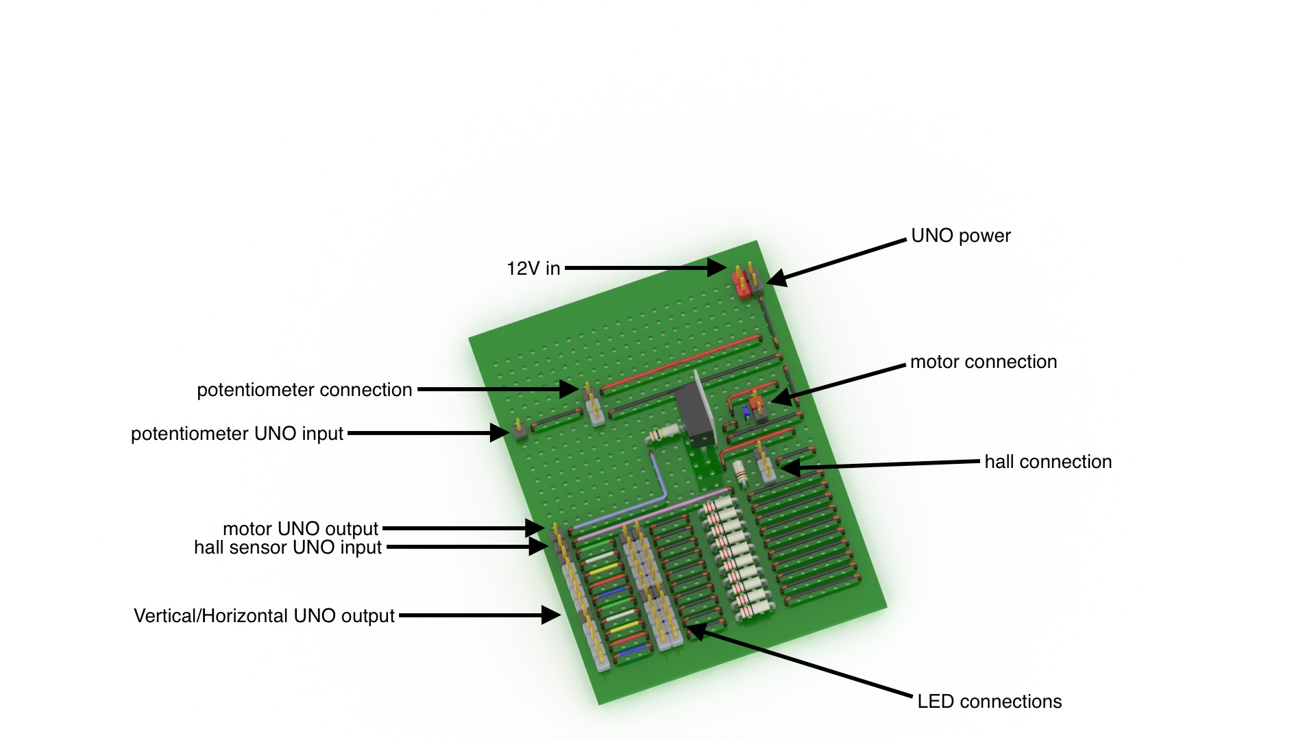

Here is a cad model of a simple circuit board I will be making to house all the components. There will be some wire looms to connect to the arduino, leds, and sensors.
I will use the 12volt power supply to power the circuit board and also arduino uno.
Your layout looks like you are using 12V with your Pot, you will need to use 5V, as 12V will cause damage to the analog input to the Arduino.
Tom.... :slight_smile:
Very good catch! I will change the voltage link and have the pot become a 2 pin connector (1 for analog pin, 2 for digital 5v pin).
