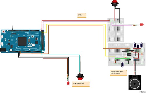

I made a quiz buzzer system based off of I like to make stuff's system. I wanted to add sound to an 8 buzzer system so I switched to a DUE from an UNO.
Issue description:
I have everything working save one problem: It doesn't always recognize the first press of the button and sometimes takes 2-3 presses of the button to get it to register and sometimes it'll work on the first press many times in a row before ignoring the first or second press. This behavior is on the reset button as well as the player buttons.
Other
I'm still pretty new to programming. I can understand how to modify different aspects of code and somehow managed to jam the code to make the tone command work on the Due into the original code but that's about the limit of my abilities at the moment. Also, if there are any optimizations I can do, any suggestions would be much appreciated
What I've tried:
I've tried switching from using pins in the 22-53 bank for the the switches to pins 2-10 and no change (in hope that the 22-53 bank had higher latency or something like that).
I was thinking it may be the code to set up the clock for the tone command (found elsewhere in these forums), but after commenting out all the code pertaining to that (reverting back to just the light for feedback) the issue persisted.
I've also attached a picture of the wiring for the reset button and one player button as well as the internal of the player (remote) button. if any other info is needed please let me know.
Thanks in advance for your help.

I can't make any sense of your wiring diagram. It is MUCH easier to wire a switch, though. Connect one leg to ground. Connect the other leg to a digital pin. Use INPUT_PULLUP as the mode for that pin.

Thanks for pointing out the switch wiring. I've redone the wiring so the buttons use the Due's internal PULLUP and changed the code accordingly.

About your Reset, How is physically connected? And for the other buttons... have you checked you resistors? And about yuor code, I think the reset part should embrace all the code...
Wiring
You can ignore any mistakes in the amp circuit. I just tried to recreate the circuit of the boards I got from amazon.
As you can see the currState and prevState go to 9, so addressing the final element should be currState[8], correct?
The reset switch is connected to pin 46 and ground, and the LED for the reset switch is pin 47 (there's a resistor attached to the LED's leg) and ground.

Still not registering the reset switch. All electrical connections are sound and as addressed.
I did test at one point using a Serial.println when it should be looking for a reset switch LOW state
 if (pollingForPresses == false)
    currState[8] = digitalRead(switchPins[8]);
    Serial.println(currState[8]);
    if (currState[8] != prevState[8])
      if (currState[8] = LOW)
and it does show it toggling between 1 (open) and 0(closed) when I toggle the switch.
It is confirmed then, the reset is wrong connected, wether if it is to make a reset just like the on board reset, or a reset specifically for the program, but i think you want to make the last option, then try this:
Solved. I'm blind. When fixing the syntax on the pollingForPresses portion, I forgot to change the syntax on the reset read portion.
which was writing LOW to currState[8] instead of
if (currState[8] == LOW)
Special thanks to PaulS for walking me through this process. I now understand a bit more coding than I did before.Your help was very much appreciated.
