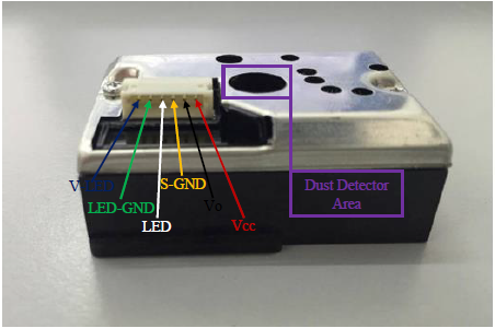

So, I've recently acquired the GP2Y1010AU0F, aka dust sensor. Normally, the sensor has 6 output pins [*attachment] :
  • VCC-ILED
  • GND
  • ILED
  • GND
  • AOUT
  • VCC

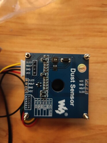

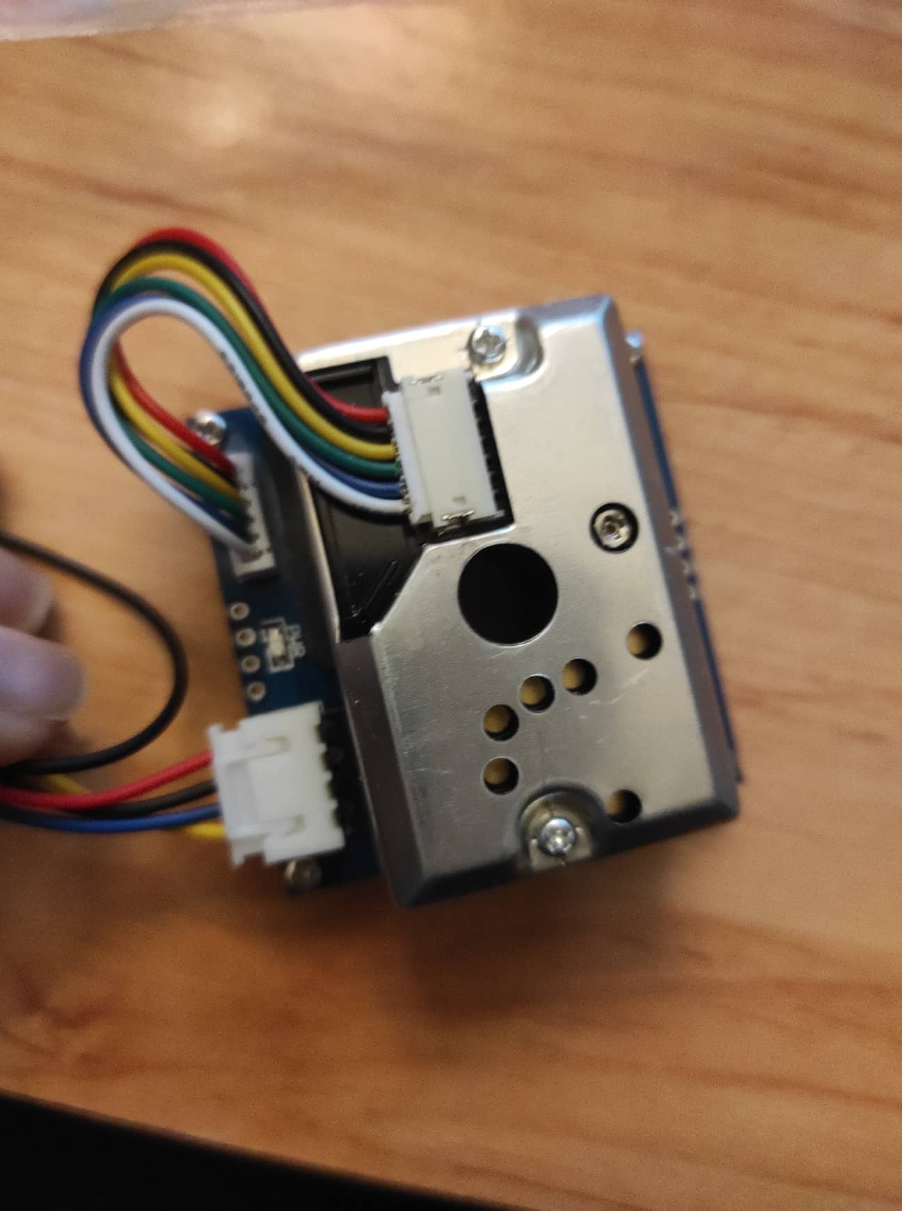

The sensor has already a pcb(?) included, which converts all those, to only 4 :
  • ILED pin 12
  • AOUT pin A0
  • GND to GND
  • VCC to 5V
I get this number constantly even if I put a pencil inside de sensor, it just doesnt move. Can someone help ? Thank you !
  • See attachments

Try writting the led HIGH, incase the board maker is using an inverter! Could you post a link to where you bought it, or the datasheet for the breakout.
Found it.
Dust SensorUser ManualWaveshare2V1.4, December2920151.2.Control principle1)Enable the internal infrared emitting diode by setting the pin ILEDto HIGH.2)Wait 0.28ms, then the external controllerstartsto sample the voltage from the pin AOUTof the module. Notes that the output wavewill take 0.28ms to reach steady state after the internal infrared emitting diode is enabled, as Figure 2shows.Figure 2:Sampling timing of output pulse3)There is a periodof 0.04ms for sampling. When finished,set the pin ILEDto LOW to disable the internal infrared emitting diode.4)Calculate the dust concentrationaccording to the relationship between output voltage and dust concentration. For more detailed information, please refer to the relative Demos.Note:Theoutputvoltagehasbeendivided(seeschematic),sothatthevoltagemeasurementshouldx11togettheactualvoltage.

I tried switching
digitalWrite(ledPower,HIGH);
  delayMicroseconds(280);
  voMeasured = analogRead(measurePin);
  delayMicroseconds(40);
  digitalWrite(ledPower,LOW);
just in case it wasn't inverted, but still got the 0's read. Might be a faulty sensor, but I'll try looking for more information.
I got another code from the web, and the results were much better .
I guess I cant trust a random code I fine (:
Thank you for your time, and be safe .
