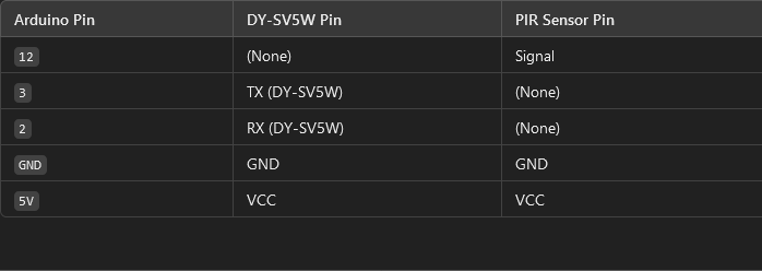

Hello,
I am trying to get the mention board to play audio through its' on board 3.5mm jack using a Ardunio uno board and a PIR sensor to trigger random sounds on the SD Card. But, for some reason, either my limited knowledge or something else I'm overlooking. I cannot get it to play thought unpowered or powered speakers.
I know that the PIR sensor and board is talking to the DY-SV5W as i can see it detect motion and says playing X track in the serial monitor. But, there is no sound.
The DY-SV5W drip switches is currently in 010, but I have tried using 100 and 001 with no differing results.
Here is the code I am using for the ardunio board. Put it get using my limited knowledge and modding code from a working DFminiPlayer sketch as the basis of my understand. It verified correctly with no problem before uploading it the ardunio.

Also here is the basic wiring in text format I used to hook up the PIR sensor, Ardunio, and the DY-SV5W.
Any help with this is appreciated as like I said, I am probably missing something obvious, but don't know I am.
