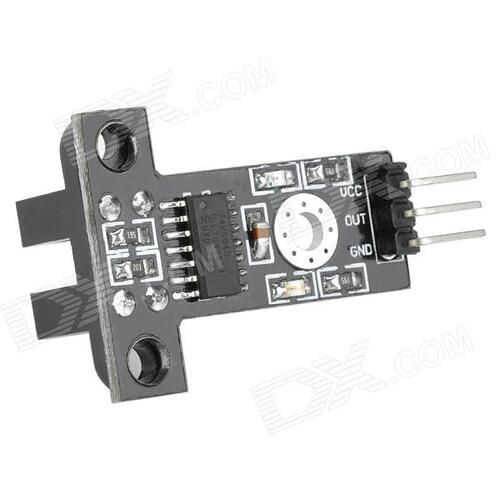

Drive shaft speed measuring with a arduino (slotted) hall effect speed sensor shield to get RPM
LM393 Comparator Speed Sensor Module for Arduino (Works with Official Arduino Boards) http://www.dx.com/p/lm393-comparator-speed-sensor-module-for-arduino-150663#.VmUaK9KrSt8

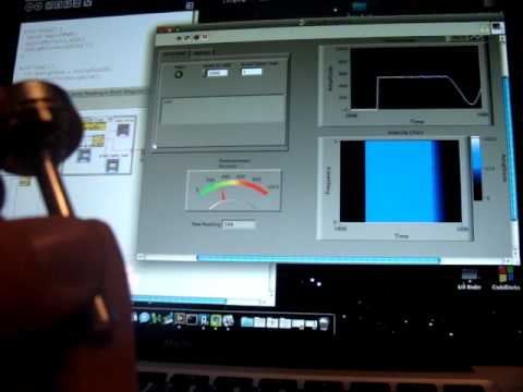

Arduino Analog Data Acquisition with LabVIEW
