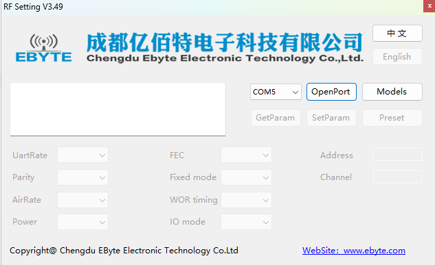

Hello I want to communicate 2 Arduino with E32 433t20d. Only sending basic message with these communication sensors. But the interface of parameter setting of E32 does not worked. I have error ' No response from module'. I use 2 Arduino nano and 2 E32. All wires are done with jumper.

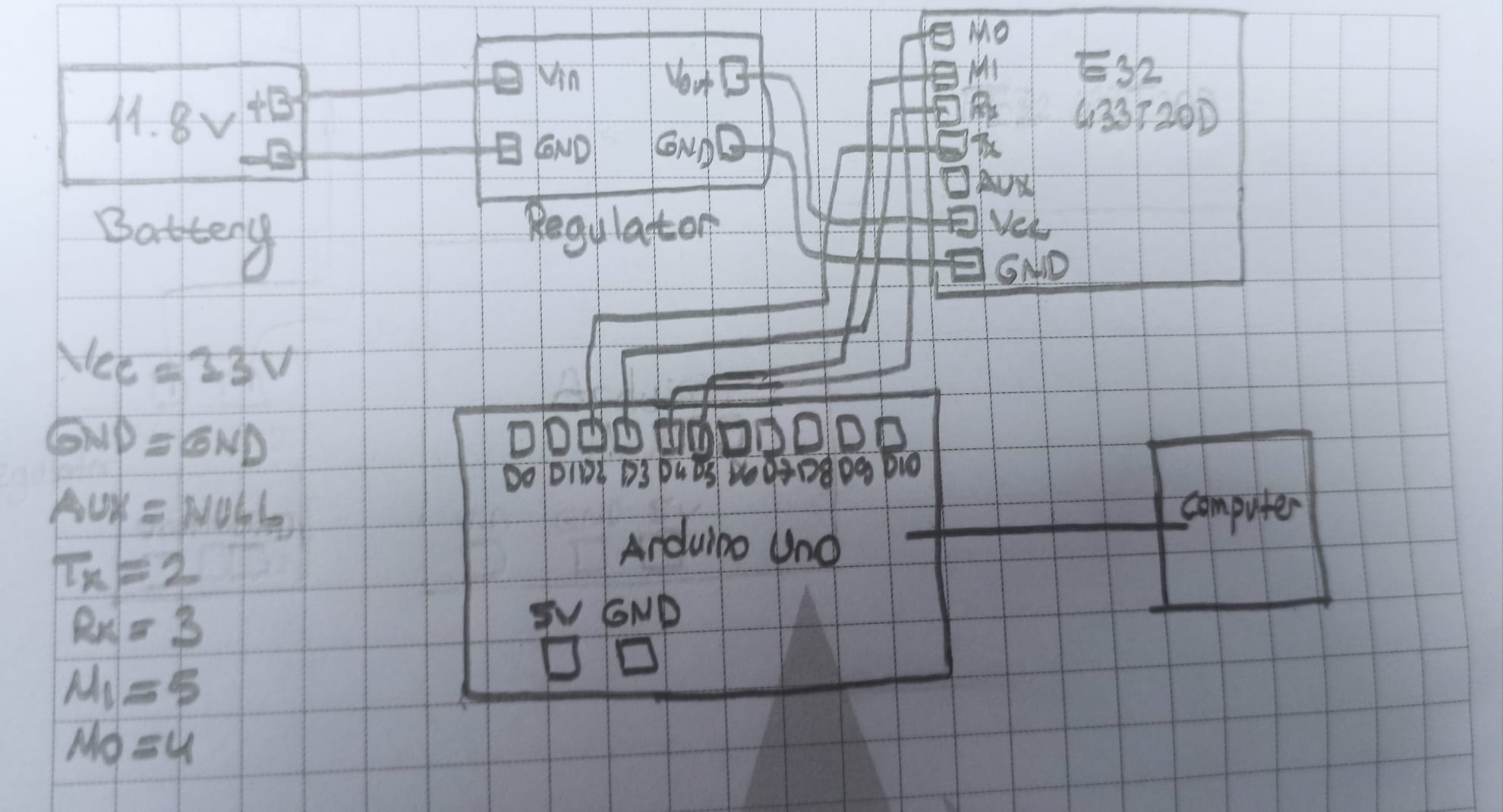

My wiring is:
GND --> GND
VCC --> 3.3V
AUX --> D6
TX --> D10
RX --> D11
M1 --> D5
M0 --> D4

And the schematic is here:

Before the code I cannot fix RF setting of E32. 'no response from module' provided. This is because of wiring or not enough voltage or current but I checked wiring many times
your code specifies pins 10 and 11 for mySerial
SoftwareSerial mySerial(10, 11); //RX, TX
but schematic shows the E32 Tx and RX connected to pins 2 and 3
also recommend you use AltSoftSerial
the Ebyte-E32 manual states the Communication voltage as 3.3V and 5V may damage the device
you need a level converter when connecting to a UNO
I always use 3.3V logic microcontrollers (e.g. ESP32) when connecting to Ebyte devices
have a look at lora-e32-device-for-arduino-esp32-or-esp8266-specs-and-basic-usage-part-1
TX RX pins are different wiring according to uno or nano for nano 10 11 used ; for uno 2 3 used

post again both codes and post a drawing of your exact circuit (paper + pencil) and power supplies

one situation is that I connect power supply directly to the E32. the other one is that I connect vcc directly Arduino 3.3V. But I am confused too many example and very different examples
Should you connect GND of the module to Arduino GND?
On page 8 of the manual, it says these cannot be left floating, can be grounded if not used.
In your circuit drawing, you have these plugged in and there's nothing in the code to address them. What are D4 and D5 doing while you run the sketch?
Also, since you're using a 5V Arduino (Nano) with a 3.3V device, the manual also talks about adding 4 10k pullup resistors to the TXD and AUX pins of the module (pg 9) for "some" 5V microcontrollers.
