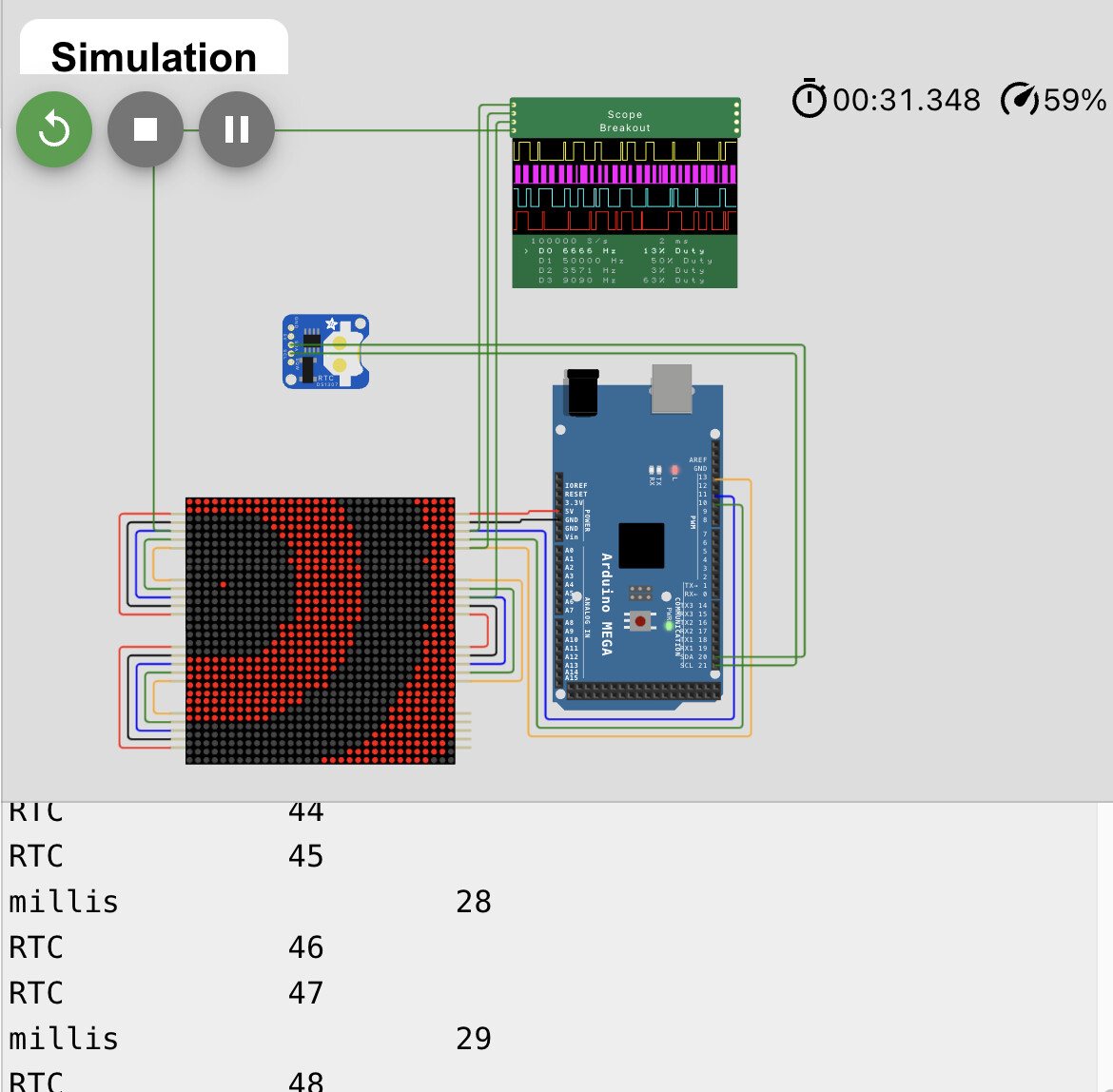

You have a slower computer. Wokwi shows an approximate speed percentage in the upper-right of the running simulation.
Ah, I thought wokwi was running from a server, didn't realize I was running it. The delay in starting the cycles is actually not a 30 second delay, it's a 1 minute delay. The Serial:print timer is accurate to real time. Just having a bit of trouble actually getting it to print once per second. Not necessary for my purposes, but these kinds of things are small exercises for me to learn. The LEDs start ramping up/down when the Serial.print timer hits 1 minute after the sunrise/sunset is supposed to start, not a big deal at all for the final use, but a bit annoying for testing and I'm still going to try to fix it.
What percent are you seeing? If you shows 50%, the sim will take 2 seconds to execute 1 second of code.
Yeah usually around that. Rather strange that the Serial.print for the RTC actually matches real time though, I hope that doesn't mean it's actually counting at double speed.
When you put your code in an MCU, you will see the difference. I have access to three computers. One runs wokwi from10% to 25%, one about 50% and one at 100% (rare usage for me). I really have to slow my code down when I move it from wokwi at 25% to the 100% computer and then the MCU because I keep thinking my code is not fast enough. You will see. Don't worry about it. You can adjust it later. I have learned to count in 1/4 seconds.

Yes. I can think of times when that would be bad. The RTC 32.768 kHz crystal should run relative to simulated speed of the microprocessor clock. It does not.

Here's a demo, but you have to run it on a slow machine to see the point:
Wokwi_badge RTC outpaces simulated passage of time.
The loop() just calls a project loop() that demands huge resources and slows simulation down on my tablet, as well as the loop I post here which uses two means of marking the passage of time:
  loopRTC();
  loopBOG();  // bog this down! and entertain us whilst
// advance and print a counter based on millis
// advance and print a counter based on the RTC

I have opened an issue on the gitHub site for wokwi.
I think any use of time, RTC or PIR timeout or whatever, should be based on the simulated clock. If the sim slows down, so must all things attached, or some sketch logic would not be faithfully (however "really" slow) execute.

On fast hardware, you can hook up a simulated scope to bog down the simulation:

Interesting. I'm seeing 3 RTC prints per millis print on my pc.
I think the demo would better avoid millis(), as that can go wrong with smart LED show() calls.
But the problem is real. My larger first proof just had the RTC printing the time, which time races ahead of the simulated running time. Shouldn't.
I'd say you need a new PC… both versions of my experiments run at 100 percent real time on the desktop machines that get any regular use, and those are pandemic years old at this point.
