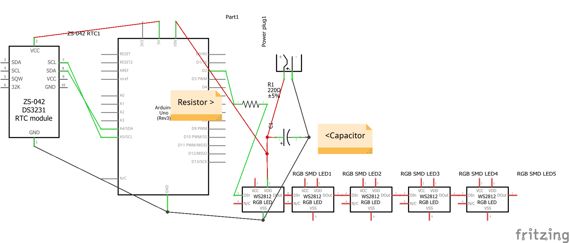

How does this look?
There are probably still some mistakes in there. I just used an uno for now, if I get this right I'll try a nano with the logic level shifters.

Your WS2812 will be in one strand, so the only connections you will need to do are the power, ground, capacitor Arduino data pin, resistor, and data-in on the WS2812.
Isn't that what I did?
Yes. The labels on all the individual WS2812 looked like they were getting connections... I thought you were going to use those connections, too. sorry.
Yeah I think that's just how they look in the program I used. So this is all good? I guess then if I build this and put the code I have on it, I have what I set out to build and more. So I only need 2 types of wire: jumper cables and 18AWG? Do I need any equipment to put 2 wires on one point like on the VSS of the first LED?
Tomorrow I will look into logic level shifters and try to make a diagram with that included.
Looks right. External power to the WS2812 with capacitor bridging power. Data line with resistor. I assume Arduino will be powered by the USB.

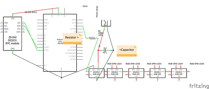

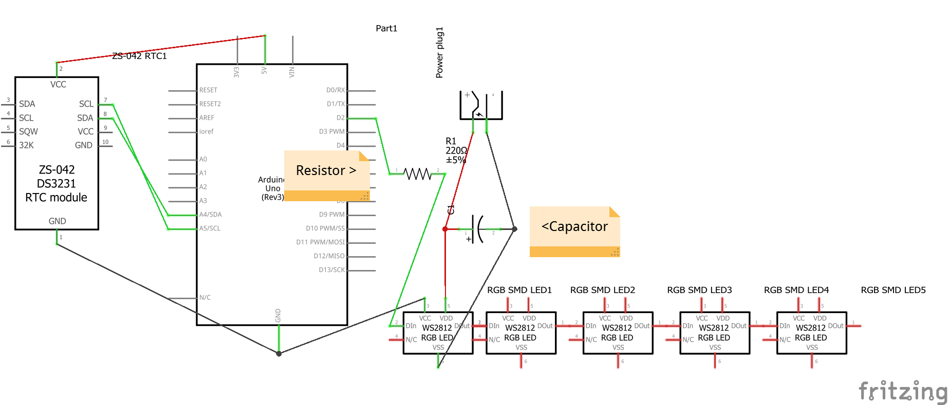

Oops, no I don't want to have it always connected to USB. How about this? Do I need an extra ground as well?
Depends on your power supply. Draw the circuit again. Write voltages, Use 90 angle wires. Do not cross lines at angles.
Isn't it all 5 volts if I use an uno?
What does the power supply you are getting say?

I was planning to buy a 5V power supply with at least 6A.

I'll give that a go. What is the purpose of drawing only 90 degrees corners though?

Easier to read (less chance of error) than lines crossing.
Got it. I'll try one in paint later.
