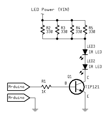

I have a problem with a simple transistor circuit I made.
The transistor won't turn on my 2 IR leds.

The resistors are placed parellel to split the current to reduce heat.
The 2 IR leds work perfect when I connect them without the TIP121 transistor.
I've also tested another TIP121 transistor, same problem.
It's strange that the transistor works when it is in use with a push button(the push button tells te Arduino to turn the transistor on).

You ONLY have resistors on your LEDS... where is the resistor on the base of of the transistor? (Yes, you need one)
I assume you want something like this:
There is no resistor for the transistor.
I saw on internet some tutorials without.
But if you say I need one, which one would be good?
It looks to me that you are missing at least 2 things:
  1. A resistor between the Arduino output and the base of the TIP121, without this you are likely to burn out the Arduino pin; and
  2. A ground wire between the emitter of the TIP121 and the Arduino, unless the ground is connected via the power supply.

  1. Which resistor would be good?
  2. The ground wire of the emitter goes to the GND of the power supply, is that a problem?
  3. They give a red glow, and I have an IR sensitive camera.

For a TIP121 it is not critical, 1K will do.

Not a problem, provided the power supply ground is also connected to Arduino ground.
I suggest you use a multimeter to check the voltage between base and emitter of the TIP121 when the LEDs are supposed to be on. It should be around 1.3V.
What is the voltage of the power supply, and what is the forward voltage drop of the IR LEDs? You have 2 in series, and together with the high saturation voltage of the TIP121, the total voltage you need may be more than 5V.

The power supply isn't connected to the arduino gnd at this moment.
Voltage between base and emitter is 0 volts, and between collector and emittor 10.6v.
Power supply is a 3s lipo(at this moment 12.4v) and the forward voltage of the IR leds is 1.5v.

See my drawing in post #2... is that what you did?
pwillard:
Yes, that's what I did.
That's the problem then. You need to connect power supply ground (i.e. negative side of its output) to Arduino ground.

Haha yes! It works now!
