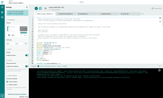

These are the 2 editor screens which I am using. I did not realise that there are 3 editors!
Old Editor The first editor Verify OK and I can also upload the sketch to a Nano 33 iot and it connects to the Arduino cloud OK. Success.
New Cloud Editor The 2nd editor Verify Fails with a Nano 33 iot specified but not connected to a usb
The 2 Editors both Verify the sketch OK if a MKR WIFI 1010 is specified but not connected to a usb. I have not attempted an MKR upload.

Thanks for the clarification.
This is a known bug with the "new" Cloud Editor. It has been reported to the Arduino Cloud developers. If you are interested in technical details, you can find an explanation here.
For now, please use either the Thing sketch editor or the "old" editor when you run into this problem. I'll add a comment here once the bug has been fixed so that you'll be able to switch back to using the "new" Cloud Editor for all your sketches again.

Hi @mackarduino. I'm happy to report that the Arduino Cloud developers have fixed the bug in the "new" Cloud Editor that caused the "Verify" operation to be considered a failure when it produced innocuous stderr output.
So you can now switch back to using the "new" editor if you like. Please let us know if you still encounter the problem.
