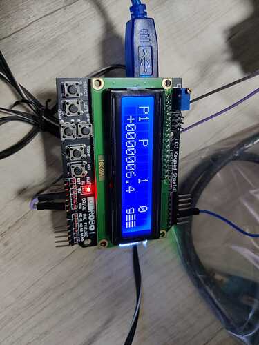

  1. When my weighing scale sends me data via RS232 (through MAX232), what format is that data in? I want to know what functions I need to use to edit this data because there are a lot of trailing zeros for instance. Also, there is the presence of the letter "g" as shown in the image which I don't want.
  2. How can I achieve this before I send the data to the LCD. I want my data to only display the weight up to 4 digits (9999). Moreover, I want to use this data that I am receiving to do something (in real life, move a piston, but in this case just glowing an LED will be enough).

The scale seems to be sending:
"+0000006.4 9XX"
Does the scale have a display? What did the display say when this value was sent? Does the scale have a way to change units (pounds, grams, ounces, kilos...)? What units was it set for? Does the output change if you set to different units?
Given your sketch and the suggestion that it actually works, your scale sends a string of ASCII characters. You can fairly easily convert these back into, let's say, a float value and strip off anything you don't need. Look up 'ascii table' on Google. There are also several C++ functions to deal with character arrays which you may find useful. E.g. this one https://www.cplusplus.com/reference/cstdlib/atof/

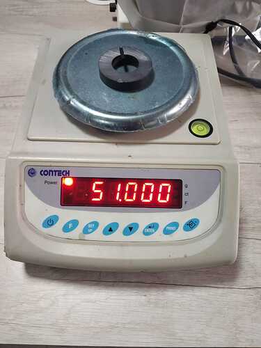

This is the display on the weighing scale. It does not change with other units, still comes as "+00000000xxx. {Unit}"
This is the data I found from the datasheet. I dont how to use this but. Hopefully you can help.
It's a Contech Weighing scale. I have provided the data sheet above.

I suspect the 9 at the end of the line is a lowercase g.
G
...and "black" is actually "blank", aka "space"
