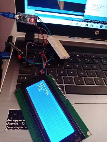

Hi Guys,
I am sending message thru Bluetooth, getting it on LCD.
I got this part working, all good.
Now I want to store that message on EEPROM.
And when device powered up , it should show that message.
Everything working but message is not showing. for some reason its showing 152.
Could you please help me to find mistake?
Here is my code

What you are writing to EEPROM is not correct. You are reading in a series of chars into your commandbuffer array but then you are writing the address of that variable to EEPROM. The write() function only writes one byte, not an entire string like lcd.print() does.
If you want to write just one byte, you would use EEPROM.write(addr, commandbuffer[0]);
If you want to interpret what is in the commandbuffer as a number (e.g. "123"), then you need to use atoi() to convert it and then write that value.
Try the following put() and get() methods instead of read() and write() methods:
EEPROM.put(addr, (char*)commandbuffer);
EEPROM.get(addr, myData);
you are reading only one byte from your eeprom. if you want a character representation instead of the byte value then you need to cast it to string or char array before you print.
yeah, I am starting to understand now. It was only one byte.
Learning about strings and arrays now.
something like that

Hi guys,
I tried arrays.
I used
value = EEPROM.get(0, myArray[X]);
and I used EEPROM.put
I arranged my array from serial reading -
if(Serial.available()>0){
myArray[X]=Serial.available();
And somehow I still get exactly the same result. LCD showing "152" after I turn it on.
Could you please point me where I should look for mistake
Also I was thinking - EEPROM has some kind of read/wright limit. So I don't want to write in it every second. What kind of solution could save EEPROM in my project?
Here is my current code

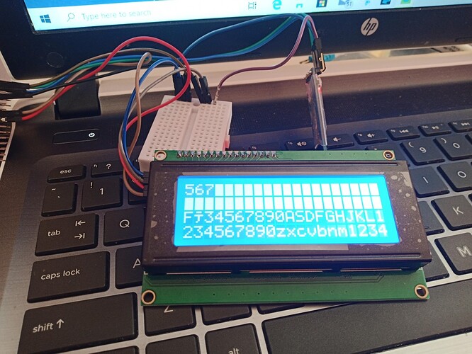

Try this code. Basically, you need to loop over your array of char (not int) and read/write each char to/from EEPROM

Thank you blh64,
I just tried it.
Its asking me to declare "i" for this line while ( Serial.available() && i < maxMessageLength - 1)
I am not sure what "i" should be. I think its 0
i tried
int i = 0;
but got that on LCD (see attached image plz)
It does show message on LCD but only for a moment!
And then it gets covered by blocks
I tried adding delays to see what happens.
I cant find it somehow
what happens now:
everything working.
message is showing on LCD from EEPROM. However only for a split second.

Its working, however after powering it up, I get just some of the text
here is two pictures: first pic is showing when text message sent thru Bluetooth terminal (sometimes it looses first symbols);
and second picture is showing LCD after powering Arduino up.
