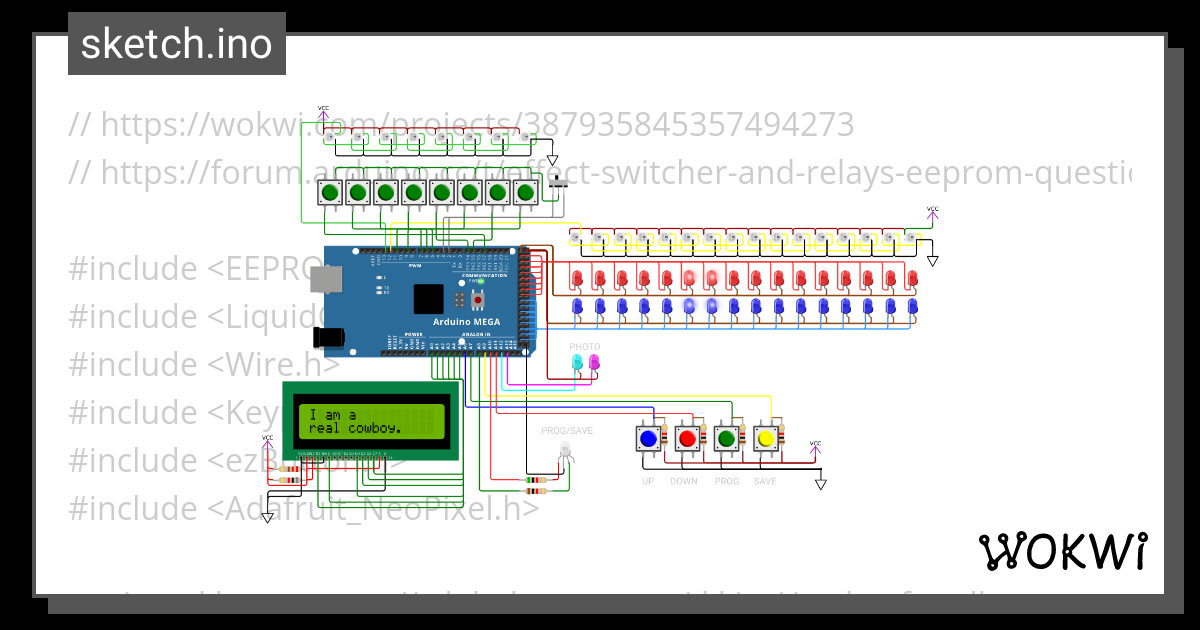

I have gone through and incorporated a lot of what you've done - obviously I had to finagle some things into my current setup, but it's working* (hehe). The wokwi:
https://wokwi.com/projects/387935845357494273
I've brought the title inline with 16 loops - I've put in all the code that was relevant per the comments written. I then went and cleaned up the code and renamed things more consistently (this may not be helpful for y'all to troubleshoot issues, but once your code is mixed with my code things start to get crowded and not make sense - apologies in advance, and arrears, for that!)
I have found a few quirks - namely, 1) the buttons are skipping worse than ever. I have a feeling there's something hitting them twice but I can't find it, and 2) when I hit save and then select a preset, the LCD goes blank. (oddly, when I tried this in bank 9, and it worked as expected, but in banks 1 and 2 it just went blank after a microsecond - very odd).
When accounting for the proper LED to light up for readPreset, it's making the LCD reset every time I hit a new preset. This doesn't bother me much, but it's just something I'm noticing.
There might be other quirks, but I haven't found em yet... If you see anything off the bat that could be causing those issues, I'm all ears. Here's my full code:

Looks like I corrected the button issue by decreasing the debounce time from 20 to 5 for each of the buttons.
And somehow the LCD is working properly now, too - that went better once I commented out the midichannel.
I gotta play with some timings, but it’s getting close! I can feel it! Hehe…
That's counterintuitive at best. I don't usually use any library for buttons, too many unknowns.
I do know that in some libraries it is essential not only to call the provided loop() service method, but to call it at a relatively high frequency.
Which our loop() should be doing without any problem. Unless somehow it has become compromised…
I'll see if I can replicate the problem. A back pocket solution would be to use my own button thing, which I don't usually in these shared code situations just to make things ez-er for those trying to run or exploit any sketches that are published.
a7
My original code had a more standardized debounce, which was set to 5, which is why I tried playing with it here.
well, I don't think that's necessary just yet, hehe... Trying to keep a level head, but I think it's looking and feeling pretty good. There's some finer details I'm thinking about, like timing of blinks and LCD displays, or what LCDs should say, or dumpEEPROM (now "alreadyStored" hehe) showing LEDs in another color - things like that.
but debugging for now is needed, and there's an annoying 8-buttons-for-16-effects issue I need to think about down the road, hehe...
I have tested ezButton and find that it can produce multiple isPressed() events as well as another method we don't use, isReleased() but only in circumstances I just do not think obtain with the current code.
IRL you may find 5 millisecond debounce time brings back some issues; I have some crappy switches that def need more than that.
Also, my friend was working her version and pointed out this

It seems to function here, even with 20 ms debounce time. I don't like hearing about the flaws as there is no good reason, please next time if you can get one into captivity and describe exactly how to make it happen let me know.
Stuff that happens occasionally or inconsistently is certainly possible, so we mightn't have observed anything like you report. That would indicate a kind of defect that will be very hard to find, so let us hope when/if the time comes the cause can be located. Things like this may mean arrays being addressed out of bounds.
We spent some time tearing out hair over the inadvertent omission of the LCD begin() method, you didn't want to be there for longer than I will admit to its haven taken to find.

We went over both versions with the finest of tooth combs w/o seeing anything jump up.
We reread your problems descriptions: When you say the LCD goes blank, is it just a flicker of blankness or do you mean there is nothing on the LCD, if so, until when?
We see nothing but the typical very brief flicker as caused by the clear() method.
a7
Updated wokwi: https://wokwi.com/projects/387935845357494273
I changed back to 20 on the debounce, and on my faster machine it's fine - I think my older Mac just doesn't like the wokwi sometimes; the speed meter in the upper right is always slower on that one than this newer one (60-75% vs. ~100% all the time). Everything works on the old Mac, but I think there's some lag in the interface at those speeds that doesn't play nice with buttons.
as for the footswitches, I should wire the ones I have to the breadboard and see how they work. I've been using tiny pushbuttons for testing, but that's not what I'm using in realtime, so this is a good reality check.
removed. good call. (also, LOL'd that my mean messaging became its own function - nice work!)
Like I said - either I'm getting cocky, or actually learning; or both! Maybe I'm just good at copy/paste and tweak until it works - but I do think I'm getting a handle on what everything is doing, which is good! Definitely a good learning exercise...
lcd.begin is in the beginLCD function, which is oddly buried in a weird spot... It just took me a minute to find it myself, lol. Maybe I'll move that closer to the void setup().
Good call on the lcd.clear; stuff - got rid of it and everything should be good now... amazing that you can just change them all at once so easily when they're all in the same spot! (this is where you take a victory lap :wink: )

We were reading the code looking for more things to mess you up with, and I noticed that in the function setupVLEDs(), you copy/pasted the initialisation dance.
The logic behind it is to confirm that the strip is wired correctly, the correct strip is being named in the object (NEO_GRB) so you get red and green and blue like you think and to light up the last LED on the strip (or chain in your case) so we know which end is which and the entire chain is wired.
It isn't worth doing but if you ever are at a loss for one more pin, there is nothing to keep a bit of logic from letting you have just one longer chain.
Also we have found the loop is moving quite fast, so when if you are ever done with this, we can make a pass and pound a little more IPO into it using just two calls to the show() methods.
We've got it running on a real Mega, you might like to use this one

I wondered about this, but figured it would be easier to keep them separate - knowing the logic now, I imagine I'd just change this:
# define ELEDS 12
# define EPIN  32
# define PLEDS 12
# define PPIN  33
Adafruit_NeoPixel eLED(ELEDS, EPIN, NEO_GRB + NEO_KHZ800);
Adafruit_NeoPixel pLED(PLEDS, PPIN, NEO_GRB + NEO_KHZ800);
to this
# define ELEDS 12
# define PLEDS 12
# define NEOPIN  32
Adafruit_NeoPixel eLED(ELEDS, NEOPIN, NEO_GRB + NEO_KHZ800);
Adafruit_NeoPixel pLED(PLEDS, NEOPIN, NEO_GRB + NEO_KHZ800);
First 12 are effects, latter 12 are presets. I could test it... (I just tested and it didn't work, hehe... I think I have to define some kind of order, so I'll look deeper into that).
Let's add it! I gotta order parts anyway, so there's some time still...

Haha, have you tried to switch banks while in programming mode?
// switching bank in any mode but READ places us back in READ mode
  if (doBank) {
    realMode = READ; // rude! this could be handled differently
The most you lose is one pass of setting up the selected loops, which while rude isn't like the old days when things didn't warn you before a misstep meant goodbye the term paper.

Still making some tweaks and had to add a photoFET for muting the relays during switching. I also started a version that has only 8 buttons for 16 effects:
https://wokwi.com/projects/388081117082022913
Currently there's a manual switch - this is simply to get functionality into the Wokwi and I fully plan to remove it.
As you said before, the banks don't work in program mode (in fact, hitting one takes you out of program mode altogether, which I should fix somehow) - but I'm thinking to create a function for the bank buttons within program mode only, creating 2 effects banks that are only active in WRITE mode (or basically bank 1: effects 1 to 8, and bank 2: effects 9-16). Once I hit save, it would default to selecting presets 1 to 16 (but I'll only have 8 buttons, so effectively presets 1 to 8).
The problem becomes how do I tell it that effectBank 1 is keys 'a' through 'h' and effectBank 2 is keys 'I' through 'p' - I gotta think through this, but it feels possible, so I'm giving it a think - even if it's a little (or a lot) hack-ish, it's better than a manual switch, right? hehe...
(believe it or not, the manual switch is helping me with the logic - gotta see what it does and functions like before telling code to do your dirty work). I think I'm actually learning something...
So thank you once more - and yet again, more to follow! hehe...

I was able to separate the preset bank from the effect bank by assigning the buttons within either READ (preset) or WRITE (effect).
So now it’s about how to write keys a-h in effect bank one and keys I through p in effect bank 2. (Such that the LEDs light as needed, and then get stored).
I moved things around, too, but in doing so the 8 buttons weren’t working quite right - I had to assign them to some crazy order of pins to get them working. Not sure what that’s about…
I’m close - and then it’s all about tweaks to timings and other miscellany.
