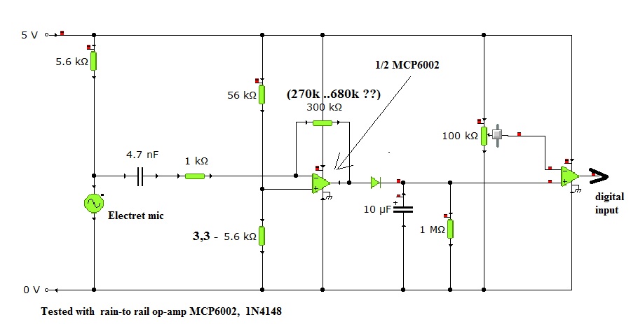

..We had no child to beat up, so they used "audacity" to generate test frequencies.
The design needs a rail to rail opamp to work. Pot-meter is linear, but any pot 10k+ will do.
Gain must be adjusted with the feedback resistor.
With sustained high freq. noise in, a voltage will bild on 10uF (leeking throud 1M) The comparator gives logical HIGH when this voltage exceeds preset V
Well that is just an amplifier and an envelope generator. What makes you think it will distinguish a child's cry from any other noise?
didnt say it will. It detects 1kHz+ above selectable SPL during a time period (few seconds).
We agree that simple electronics cant replace moms ear..
