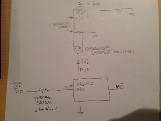

I can not replace the pot because the resistor is actually a thermal coolant sensor.
I am looking at that first ebay link you put up as well. it appears to possibly work My concern is I am controlling a coolant pump based off a precise voltage value from a coolant sensor so the calculations need to be precise. Normal operating temp is around 2.5v INput which result in a 6V OUT to the pump working at 1/2 efficiency.
I am trying to put together a circuit see attached image below.
The Capacitor, Diode and resistor on the PIN3 output I am not sure are the correct values.
Additionally I was directed to a IRF630NS Rectifier which may be capable of handling the current.
The schematic you posted doesn't show any Motor power supply or connection point for the power supply. It should be shown at the (+) terminal of the motor . Also the entire circuit should be rotated CW 90 degrees to conform to standard schematic format.
Turn the entire drawing CW 90 degrees and redraw the labels so they are right side up with the new orientation. As shown it looks wierd and screams "No experience drawing schematics !"
