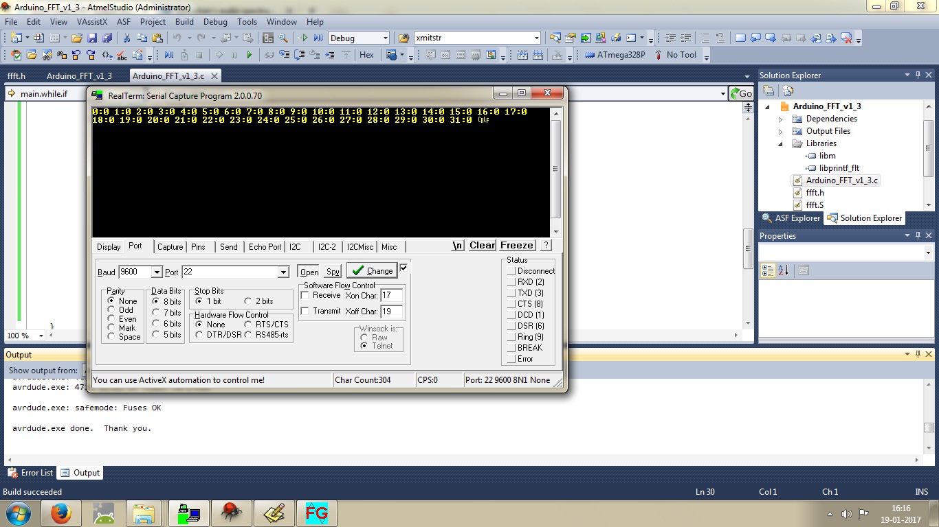

Now let me give you some real data that I noticed....
When I am applying a 900Hz signal at my laptop output and running a FFT on my Rigol 1102(sample rate 250ksps),then I am getting a 1v Vrms value.
But
When i am running this library and applying the same 900Hz to the circuit and then reading the 6th buffer element(Buffer[6]) on realterm,Then it is showing a value of around 4.4k.
My question is what i am supposed to understand or how to process the output of the buffer???I am attaching a screenshot for your ref.....
One thing is for sure,that i am getting values at the desired buffer elements(Excepting 0 & 1) for any known frequency....
For say,location 6 for 900Hz signal....Please check the Pic attached....
Remove the DC offset by subtracting from each element the average value of the input array, and see what happens.
Please be a little bit elaborate....
The original example program is substracting 32768 from The ADC output and then storing the data to the buffer....like this below
*buffer++ = ADC - 32768;
I also tried with that.But that is only changing the Buffer[0] and Buffer[1] data.Rest are being the same!!

Ok guys!!I have found a problem in the original program.The main capture program was written like this below
void capture_wave (int16_t *buffer, uint16_t count)
ADMUX = _BV(REFS0)|_BV(ADLAR); // channel
do {
ADCSRA = _BV(ADEN)|_BV(ADSC)|_BV(ADATE)|_BV(ADIF)|_BV(ADPS2)|_BV(ADPS1)|_BV(ADPS0);
while(bit_is_clear(ADCSRA, ADIF));
} while(--count);
ADCSRA = 0;
ADLAR bit was set so the data must be left adjusted.So in order to read the ADC value,one must read the ADCH register only to get a 8 bit data.But the author is reading the whole ADC register after ADLAR bit is set.

    Now I am attaching two screenshots applying 900Hz signal to the ADC and in the other nothing is applied and at last,I am getting 0s.
    But still now i am confused about the output value range.....Please reply!!
