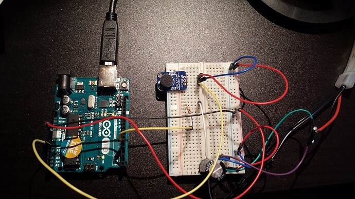

i have also attached a picture of my Circuit.
The microphone looks like this one from Adafruit Electret Microphone Amplifier - MAX4466 with Adjustable Gain : ID 1063 : $6.95 : Adafruit Industries, Unique & fun DIY electronics and kits
Pete

The OP's code looks a bit odd but it does handle the DC offset correctly. The values seen by the FFT will be in the range -32768 to +32767 as they should be. Although, I'm not sure that they need to be shifted up by 6 bits. Perhaps try not shifting them at all and subtract 512 to do the DC offset.
I'm wondering if the microphone circuit is generating enough of a signal.
Pete

I still see the values 220-224 in frequency bin 0-74hz and 200-203 in 75hz to 150hz.
If I use the 10 bits from the ADCH and ADCL registers, the maximum value that I can get from the ADC is (2^10) -1 = 1023, if the values are right shifted. So shouldn't my offset be 1024 instead of 512?
I haven't thought from the microphone's point of view, but with the Parralax sound sensor, I do see a tiny led in the sensor flash, whenever it receives a sound of a particular decibel level. Previously I had used the same circuit without the ADC free run mode but the single capture mode. I used to get some value as I could print them on the screen.
No. The ADC range is 0 to 1023. You want these values to be shifted so that they are centred around zero, so subtract 512 which gives a range of -512 to +511.
I would try to print out the raw ADC values to see if they are changing significantly when there's a change in the sound level at the microphone.
I have a vague memory that if you increase the sampling of the ADC, it reduces the number of significant bits. You may only be getting 8 bits.
Pete
Again, this is due to a DC offset.
You are not subtracting the average value of the signal, with no audio input.
That value has to be measured for your input circuit.
Here is what I mean for handling the ADC:
byte low = ADCL; // fetch adc data
byte high = ADCH;
int value = (high << 8) | low; // form into an int
value = value - zero_offset; //zero_offset is the average ADC value with no audio input
When you have determined zero_offset properly, the value of the 0 Hz amplitude bin should be about 0 (assuming you are using fft_mag_lin() to determine amplitudes).
The window function spreads the DC offset into neighboring bins.

Hi jremington,
As suggested, I am trying to figure out the average zero offset value. To do that, I made some changes to the code. What I am doing is to make the ADC run in the Free running mode, with the ADC value left shifted like my above code and output just the ADC value without any music or sound.

From this and some prior reading of FFT, I came to the conclusion that windowing is necessary so as to prevent spectral leakage and also to ensure the sense of continuity in the audio signals. As we can see with windowing test, some of the signals in other frequency bands have some energy present which would not have been noticed had windowing not been used.
Now I can also confirm one more thing. Even a tiny value of 100 can result in a significant value present in the frequency bins 0 and 1. Is this why we need to subtract this offset from our input audio sampled signal?
And now that I have gone through this exercise, is my approach to calculate the average zero offset value the right approach?
Thanks for all the explanation and the help, especially with the DC offset test code. I believe I have learnt a lot over the course of our correspondence. Appreciate it.
Thanks
Prakash
I still see a big value in the frequency bins 0-74hz and 75 to 150hz. This is the code that have used that incorporates the DC offset value:

I have also attached the serial port output with two tests. One had no sound and the other has a 600hz sine wave sound input to the sound sensor. Are we expected to see numbers in the frequency bins 0-74hz and 75-150 hz? Even in the DC offset code, even though we had the same value of 100 at each of the samples, It was the Frequeny bin 0 and 1 that had reading of amplitude magnitude greater than 20. I am I missing something here? Looks like no matter what values you have, the first two bins have a greater value than the other frequency bins. Is this expected?
Thanks
Prakash
