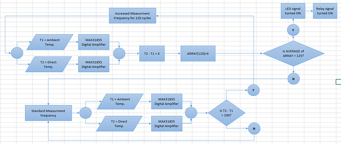

We are building this code to take temperature measurements in a for loop and input them to an array. The goal is to average the array values. The following is a flowchart with our thought process.
This is the code we have developed. We are unsure of where the array needs to be created, how to create it in this context, and how to average the values.

You don’t need an array with all the values If you only want the average
Calculate the sum of all the readings and at the end divide the sum by the number of samples
It looks like your flowchart is:
  do
    int t1 = GetAmbientTemperature();
    int t2 = GetDirectTemperature();
  } while (t2-t1 <= 100);
  long total = 0;
  for (int i=0; i<120; i++)
    total += (t2-t1);
  int average = total / 120;
  if (average > 125)
    digitalWrite(LEDSignalPin, HIGH);
    digitalWrite(RelayPin, LOW); // Active Low
Do you really never want the LED or Relay to turn off? That's what your flow chart is saying.
