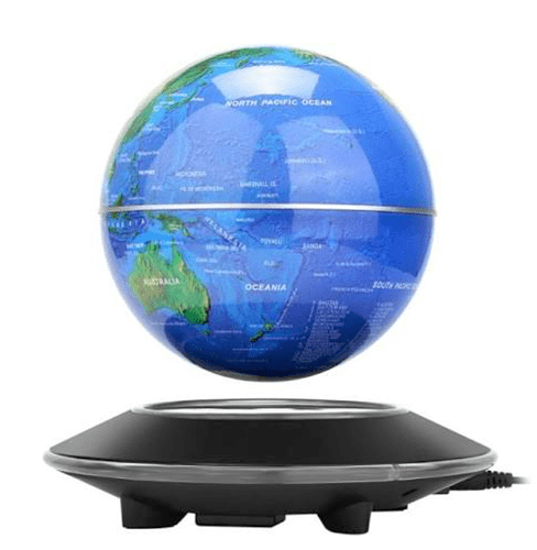

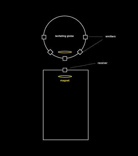

I was wondering if it's possible to create a system of sensors that uses multiple emitters for a single receiver. As you can see in the diagram I have attached, I'd like to use a hovering globe (using a levitation display – see the picture below) and fit it with 5 emitters in the position of different world countries.
Ideally, when an audience member rotates the globe and places a specific country/emitter above the receiver, a connection is made and a piece of data is send to the board and IDE, which then triggers a specific thing to occur. My question is: is it possible for the different emitters to send different values to the receiver when they are in close proximity, in such a way that Arduino sends them to Processing through a serial connection? How would I go about doing this? What's the best type of sensor?
I wonder if there would be too much interference between the emitters.

First get the hovering globe to hover while people are handling it.
Paul
What are the emitters imagined to emit?
Can your problem be restated as "I have a hovering globe and I want to know its current orientation and do some specific action depending upon that orientation"?
If so, I think that opens up the solution space.
