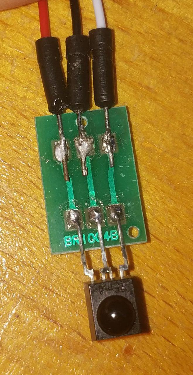

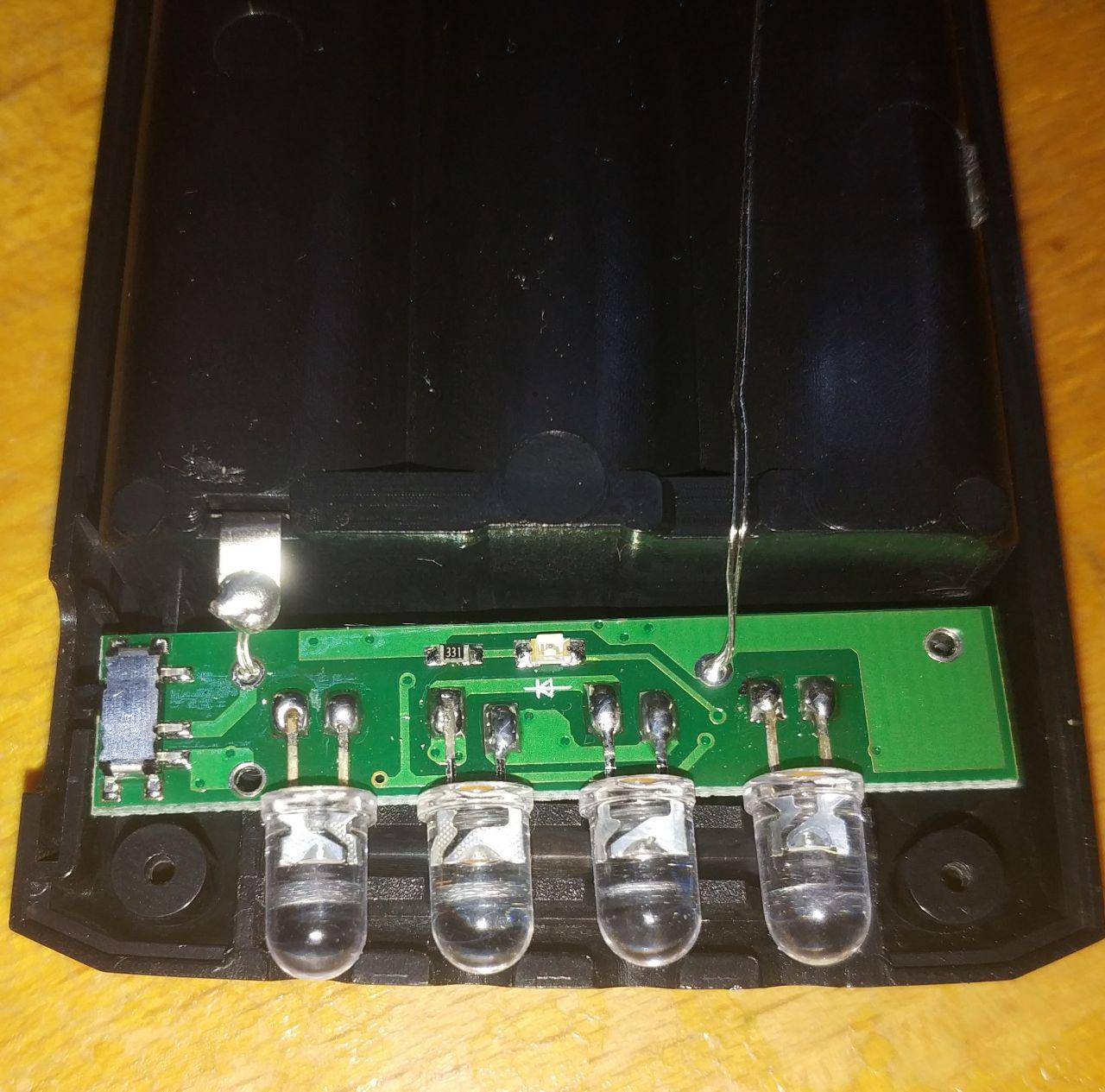

I've attached 3 photos. 2 of them are the sender (the bigger one). The last photo is the ir receiver sensor.
I don't have the schematics of both.
I have found this one, it's very similar to the one i have, but not exactly the same. If i'm able to find the right one I'll send a link.

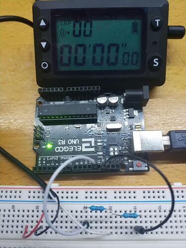

Then I've already tried doing so but the chrono is not moving. I've tried again in case i did some mistake (see the attached photo) and with this connections it's not working.
I tried to send single spikes, series of spikes, inverted spikes (kept the out high and when i wanted to send the signal set to low) but nothing is working. So i guess this is not the right way.
However, when i tried to make some changes in the connection and forgot to power off the chrono, it stopped the time. Don't know why and how, but sometimes it did (very few times).
p.s. the resistance of the photo are: R1 220 (the left one), R2 330 (the right one). Let me know if this the right way of making a voltage divider or if i did it wrong.
In that picture I'm missing the GND connection. The chrono will not see the spike as it doesn't have a reference.
In this test I was trying without the ground of the receiver, but in my first test i connected both the grounds together in the spot u see in the pic. I've made several combinations but with simple spikes, it seems not to work

Now i'll have to implement to the main software. Ah and I used the voltage divider for the connection (the same i used in the photo but with both the grounds connected together).
