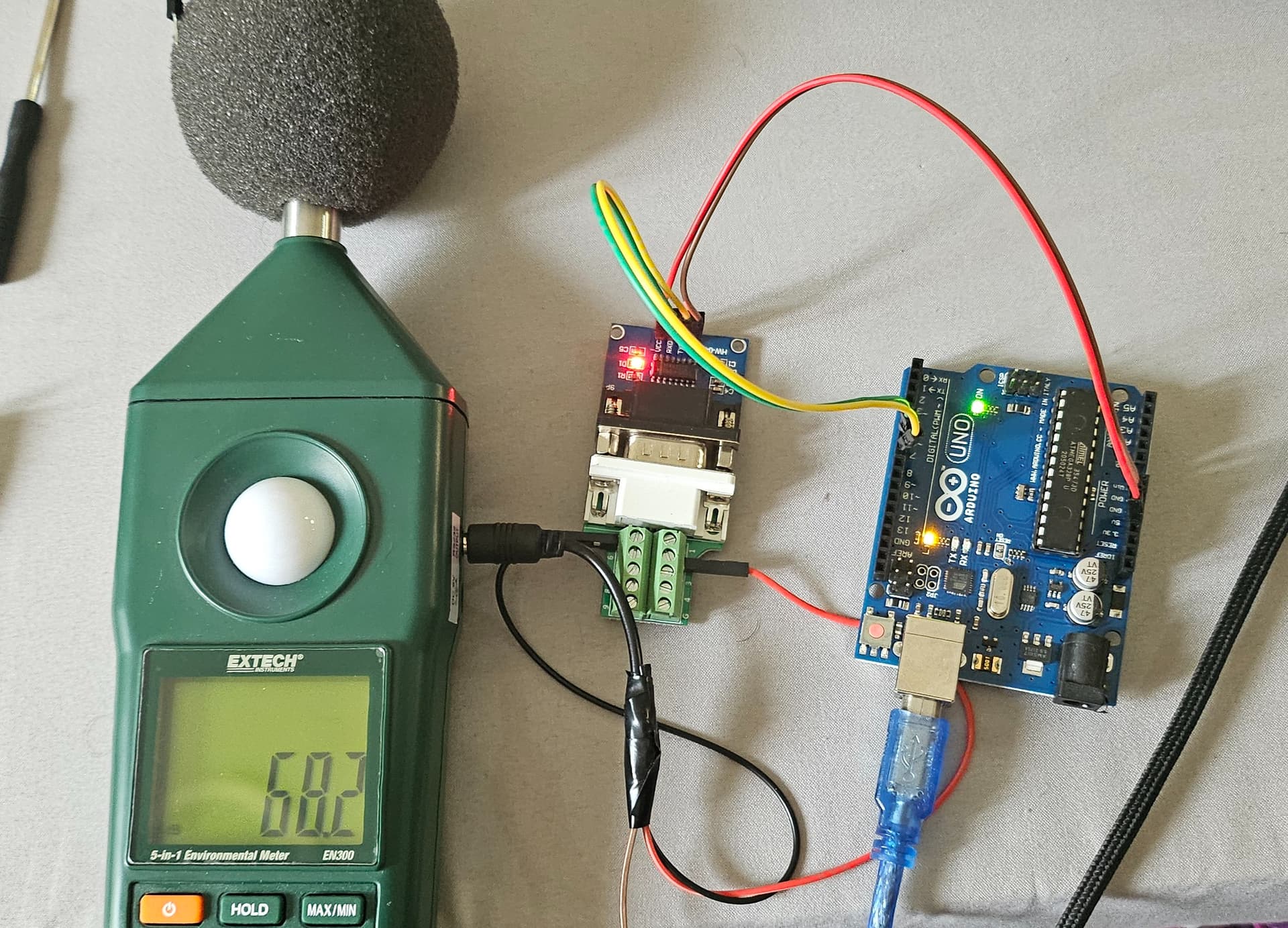

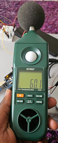

I am using En300 Environmental Meter to measure Decibel Level and to display in serial monitor, Arduino Code IDE is as follows. The serial monitor result is not the same as the display in En300. I Understand the serial has 4 channels, one for Temp, Lux, RH and DB. how to get the right reading in arduino serial, please help. the current serial output is repeating 2,67,66,66,255 and repeating the same where the decibel reading is around 45~50 but corresponding changes are not reflecting in serial output. i also tried connecting a RS232 converter but not output in serial.

Is the RS232 output from the meter connected directly to the Uno as your 'photo would seem to indicate ?
yes,
The RS232 signal levels are not compatible with the TTL input of the Uno. You need an RS232 to TTL converter between the two and a common GND connection
Something like this perhaps
i tried to connect with Rs232, and using the same ardiono code as above, but no serial data updates in serial monitor. Tx led in Ardiono doesnt bling

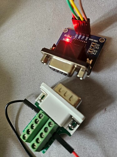

  1. Connected En300 GND to DB9 PIN 5
  2. Connected EN300 Signal pin to DB9 PIN 2
  3. Connected TTL VCC, GND to Arduino 5v and GND

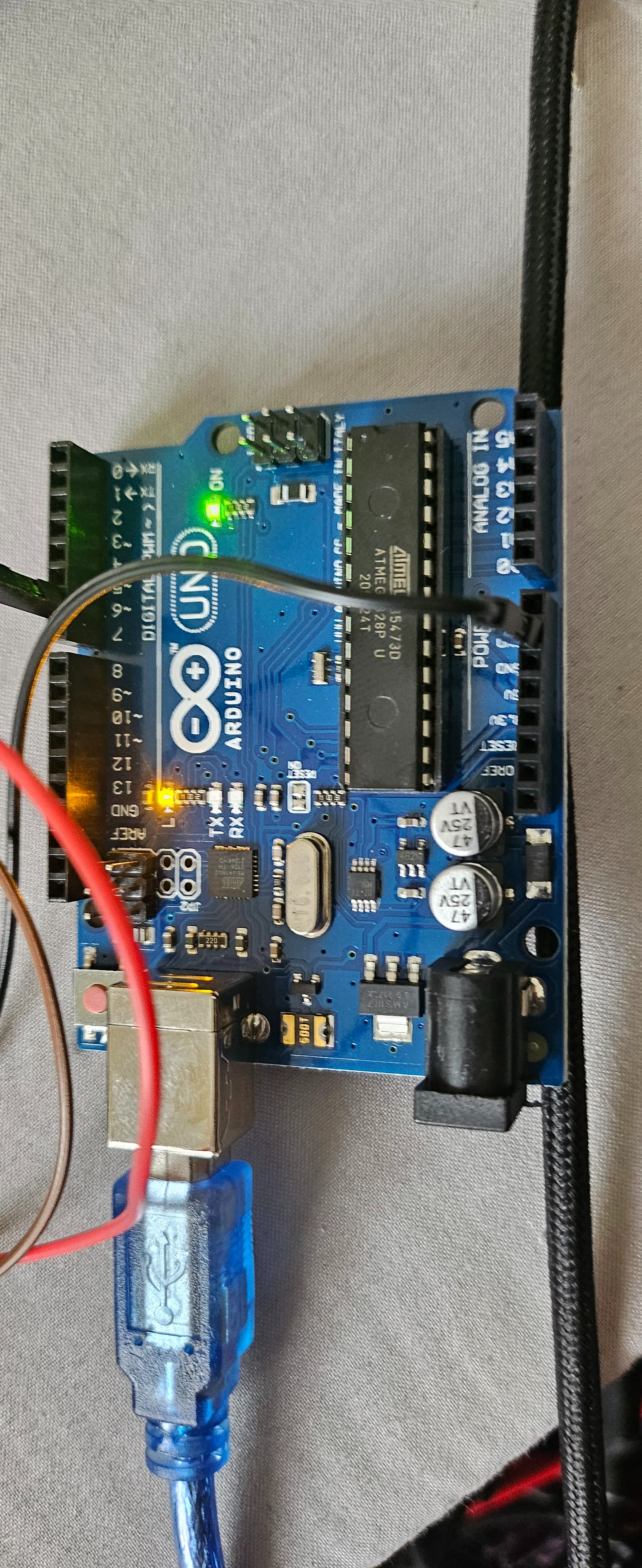

  4. Connected TTL Rx to Arduino PIN 6 as in code
  5. Connected TTL Tx to Arduino PIN 7 as in code

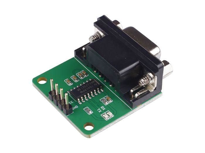

What exactly is the board between the meter and the Uno in your 'photo ?
its a Db9 male and rs232 converter connected, RS232 with MAx3232 chip
if you have a multimeter it is worth checking the RS232 voltage to ensure you have Tx and Rx connected correctly, e.g. the female 9-pin D-type connector on the TTL/RS232 module should be
the TX signal from your En300 meter should be between -6 and -12 volts
connect it to pin 3 of the TTL/RS232 module

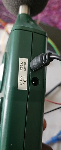

As you can see in the photo in the device En300 it says RS232 output and i connected the 3.5mm Jack other than GND signal came only in the ring, so only 2 wires came out and the voltage is less than 1v. I connected the respective Tx and GND to HW-597 USB to TTL converter and connected the usb to pc and i received the data @baudrate 9600. Now i have ditched the Arduino and connected the HW597 to the rpi4 i had and using it. It will be very helpful if this can be accessed via Arduino Uno
