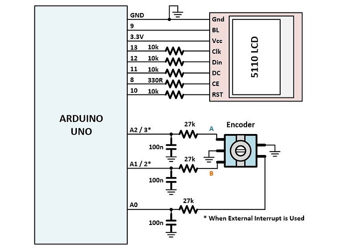

Typical wiring:

Do not see pull ups on the encoders :thinking: .
Do not see bounce suppression capacitor s on the encoders :thinking: .

@LarryD In the picture you posted does it show a pullup resister of 27k or 2.7k. I've been reading that I should use something in the range of 1-10k.
