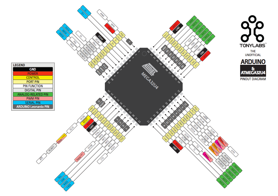

Atemag 32U4 has enough interrupt-enabled pins to support 2 Encoders. So, I wouldn't bother with timer interrupts.
Pin Change interrupts are on all pins! :slight_smile:
(Ooops... Only 8 pins on ATmega32U4!)
You only have to check which one of the two triggered the interrupt.
Point being?
Of course - not.
Also you can see in datasheet of 32u4. https://ww1.microchip.com/downloads/en/devicedoc/atmel-7766-8-bit-avr-atmega16u4-32u4_datasheet.pdf
Sorry. Only ATmega328p has PCINTs on all pins:
https://www.researchgate.net/figure/Atmel-MCU-ATmega328-and-the-Arduino-pin-out_fig10_312372376
32U4 has only PC0...7, then 8 pins.

32u4 has five interrupt-capable pins. Go back and read Post #7. Open the MultipleEncoder example. Modify it for only two encoders and use four of the interrupt-capable pins.

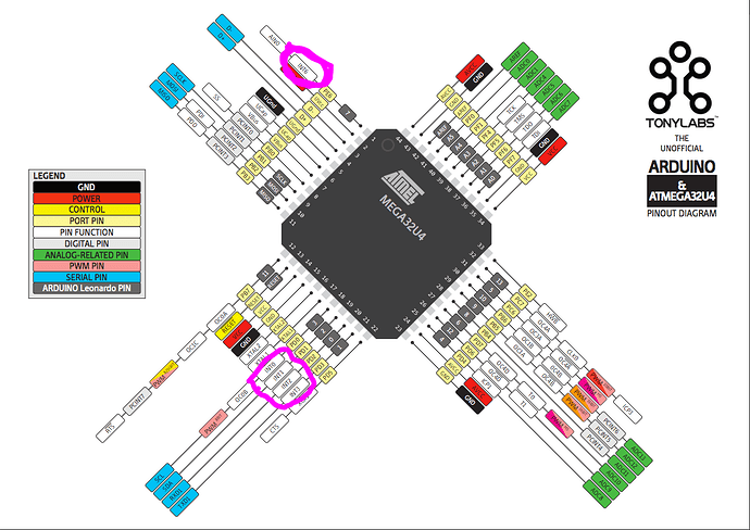

As an arduino micro = Atmega 32U4 has 5 interrupt-pins the new-enocder-library works very well.
I have modded my connection to get on all pins of both encoders PCINT.

First, the NewEncder library does not support "Pin Change Interrupts (PCINT)". It only supports "External Interrupts". These are the interrupts that work with the attachInterrupt() function. I've indicated them in the diagram:
Where do you see those defines? They are only in the library source code that you don't need to open. The only thing you need to open is MultipleEncoders.ino!

Ok, so Im still loking for library with PCINT.
SCL SDA I need for i2c.
TX RX UART I need for communication between devices.
Look up pinchangeinterrupt in the IDE (2.0.2) library folder.
If you use the NewEnocer-library you specifiy 4 IO-pins out of these 5
and you are done.
The encoder-counter wil be updated by interrupt autmatically
best regards Stefan
NewEncoder-library uses INT, not PCINT. INT pins I need for i2c and uart.
PJRC also use INT, not PCINT.
