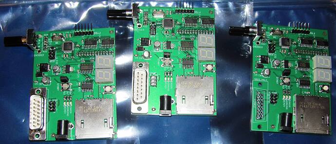

And put the parts for 1 encoder into my sketch on pins 9 (A) & 8 (B).

So my /libraries folder now has a folder /AdaEncoder and /ooPinChangeInt, and ByteBuffer, cbiface, and cppfix.
Closed the IDE and restarted. In my Contributed libraries, I see AdaEncoder and ooPinChangeInt.
When I compile I get these errors:
In file included from Rev6CardTest.ino:21:
C:\Users\CrossRoadsFencing.CrossRoads\Documents\Arduino\ArduinoStuff\libraries\ooPinChangeInt/ooPinChangeInt.h:94:32: error: ../cbiface/cbiface.h: No such file or directory
C:\Users\CrossRoadsFencing.CrossRoads\Documents\Arduino\ArduinoStuff\libraries\ooPinChangeInt/ooPinChangeInt.h:162: error: 'CallBackInterface' has not been declared
C:\Users\CrossRoadsFencing.CrossRoads\Documents\Arduino\ArduinoStuff\libraries\ooPinChangeInt/ooPinChangeInt.h:171: error: ISO C++ forbids declaration of 'CallBackInterface' with no type
C:\Users\CrossRoadsFencing.CrossRoads\Documents\Arduino\ArduinoStuff\libraries\ooPinChangeInt/ooPinChangeInt.h:171: error: expected ';' before '*' token
C:\Users\CrossRoadsFencing.CrossRoads\Documents\Arduino\ArduinoStuff\libraries\ooPinChangeInt/ooPinChangeInt.h:189: error: 'CallBackInterface' has not been declared
C:\Users\CrossRoadsFencing.CrossRoads\Documents\Arduino\ArduinoStuff\libraries\ooPinChangeInt/ooPinChangeInt.h:190: error: 'CallBackInterface' has not been declared
C:\Users\CrossRoadsFencing.CrossRoads\Documents\Arduino\ArduinoStuff\libraries\ooPinChangeInt/ooPinChangeInt.h:303: error: 'CallBackInterface' has not been declared
C:\Users\CrossRoadsFencing.CrossRoads\Documents\Arduino\ArduinoStuff\libraries\ooPinChangeInt/ooPinChangeInt.h: In member function 'void PCintPort::enable(PCintPort::PCintPin*, int*, uint8_t)':
C:\Users\CrossRoadsFencing.CrossRoads\Documents\Arduino\ArduinoStuff\libraries\ooPinChangeInt/ooPinChangeInt.h:307: error: 'class PCintPort::PCintPin' has no member named 'pinCallBack'
C:\Users\CrossRoadsFencing.CrossRoads\Documents\Arduino\ArduinoStuff\libraries\ooPinChangeInt/ooPinChangeInt.h: At global scope:
C:\Users\CrossRoadsFencing.CrossRoads\Documents\Arduino\ArduinoStuff\libraries\ooPinChangeInt/ooPinChangeInt.h:324: error: 'CallBackInterface' has not been declared
C:\Users\CrossRoadsFencing.CrossRoads\Documents\Arduino\ArduinoStuff\libraries\ooPinChangeInt/ooPinChangeInt.h:364: error: 'CallBackInterface' has not been declared
C:\Users\CrossRoadsFencing.CrossRoads\Documents\Arduino\ArduinoStuff\libraries\ooPinChangeInt/ooPinChangeInt.h: In member function 'void PCintPort::PCint()':
C:\Users\CrossRoadsFencing.CrossRoads\Documents\Arduino\ArduinoStuff\libraries\ooPinChangeInt/ooPinChangeInt.h:444: error: 'class PCintPort::PCintPin' has no member named 'pinCallBack'
In file included from Rev6CardTest.ino:22:
C:\Users\CrossRoadsFencing.CrossRoads\Documents\Arduino\ArduinoStuff\libraries\AdaEncoder/AdaEncoder.h: At global scope:
C:\Users\CrossRoadsFencing.CrossRoads\Documents\Arduino\ArduinoStuff\libraries\AdaEncoder/AdaEncoder.h:120: error: expected class-name before '{' token
Rev6CardTest.ino: In function 'void setup()':
Rev6CardTest:68: error: cannot call member function 'void AdaEncoder::addEncoder(char, uint8_t, uint8_t)' without object
Rev6CardTest.ino: In function 'void loop()':
Rev6CardTest:83: error: 'encoder' was not declared in this scope
Rev6CardTest:83: error: 'thisEncoder' was not declared in this scope
What more do I need to do to get the libraries recognized?

It's this one
with the filter circuit on page 2 of its drawing
What I want to do is cycle thru 00 to FF on the display to select a file, no high speed motor shaft tracking or anything critical.

That works great with my encoders.
How do I use it to count up from 00 to FF then wrap back to 00, and similarly count from 00 and wrap up to 255?
Right now I just have the code dumbly counting 0 to 9 and back to 0 to show the hardware is working, while the encoder counts merrily up & down on the serial monitor.
I tried changing the encoder.h code to have the count wrap there, but not successfully.
Then it dawned on me that I really wanted the +1, -1 returned back to the program so the program could do something with it, and I can't figure out how to get that #.
Thanks
Robert

CrossRoads:
If you just want an 8-bit counter that is wrapping over at 255/0 instead of the default 16-bit int counter, you simply can use the lower byte of the counter:
  if (updateEncoders())

CrossRoads:
How do I get just the +1, -1 back?
The counting and synchronizing with the volatile variables is hidden in the update function.
And you don't count 0 or +1, -1 only with every update, possibly.
If you don't update each and every millisecond, the count may increase or decrease by 2, 3 or more with one update while rotating fast and updating slow.
So why not use the lowByte from the counter, extract the upper and lower nibble and send directly?
Code suggested:
// added rotary encoder demo by 'jurs' for Arduino Forum
// This is the code for the main "sketch"
#include "encoder.h"
#include <SPI.h>
// test of pins - press start to light LEDs, press select to turn off LEDs
byte redLed = 14;
byte greenLed = 15;
byte yellowLed = 16;
byte selectPin = 3;
byte startPin = 2;
byte shiftRCK = 19;
byte shiftSCK = 18;
byte shiftSerial = 17;
byte fontArray [] = {
  0b00111111, // 0
  0b00000110, // 1
  0b01011011, // 2
  0b01001111, // 3
  0b01100110, // 4
  0b01101101, // 5
  0b01111101, // 6
  0b00000111, // 7
  0b01111111, // 8
  0b01101111, // 9
  0b01110111, // A
  0b01111100, // b
  0b00111001, // C
  0b01011110, // d
  0b01111001, // E
  0b01110001, // F
  0b00000000, // blank
byte lowerDigit = 0;
byte upperDigit = 0;
void setup(){
  pinMode (shiftSCK, OUTPUT);
  pinMode (shiftRCK, OUTPUT);
  pinMode (shiftSerial, OUTPUT);
  pinMode (redLed, OUTPUT);
  pinMode (greenLed, OUTPUT);
  pinMode (yellowLed, OUTPUT);
  pinMode (selectPin, INPUT_PULLUP);
  pinMode (startPin, INPUT_PULLUP);
  SPI.begin();
  beginEncoders();
void loop(){
  if (digitalRead(startPin) == LOW){
    digitalWrite (greenLed, HIGH);
    digitalWrite (redLed, HIGH);
    digitalWrite (yellowLed, HIGH);
  if (digitalRead (selectPin) == LOW){
    digitalWrite (greenLed, LOW);
    digitalWrite (redLed, LOW);
    digitalWrite (yellowLed, LOW);
  if (updateEncoders()){
     byte myCount=encoder[0].count; // use only lower byte of counter
     upperDigit= myCount>>4; // shift high nibble 4 bits to the right
     lowerDigit = myCount & 0b1111; // keep only the low nibble
 // now update the display
    digitalWrite (shiftRCK, LOW);
    shiftOut(shiftSerial, shiftSCK, MSBFIRST, fontArray[upperDigit]);
    shiftOut(shiftSerial, shiftSCK, MSBFIRST, fontArray[lowerDigit]);
    digitalWrite (shiftRCK, HIGH);
Doesn't that work for your counter digits?
I'll try it. I feel dense looking at software I didn't write sometimes. Gotta get some dinner before I do anymore.
Been assembling cards, bootloading, prepping for shipping all afternoon, head's not in the programming game at the moment. Thanks for sticking with me on this.
Didn't eat yet, but the code's working :slight_smile: Thanks very much jurs :grin:
