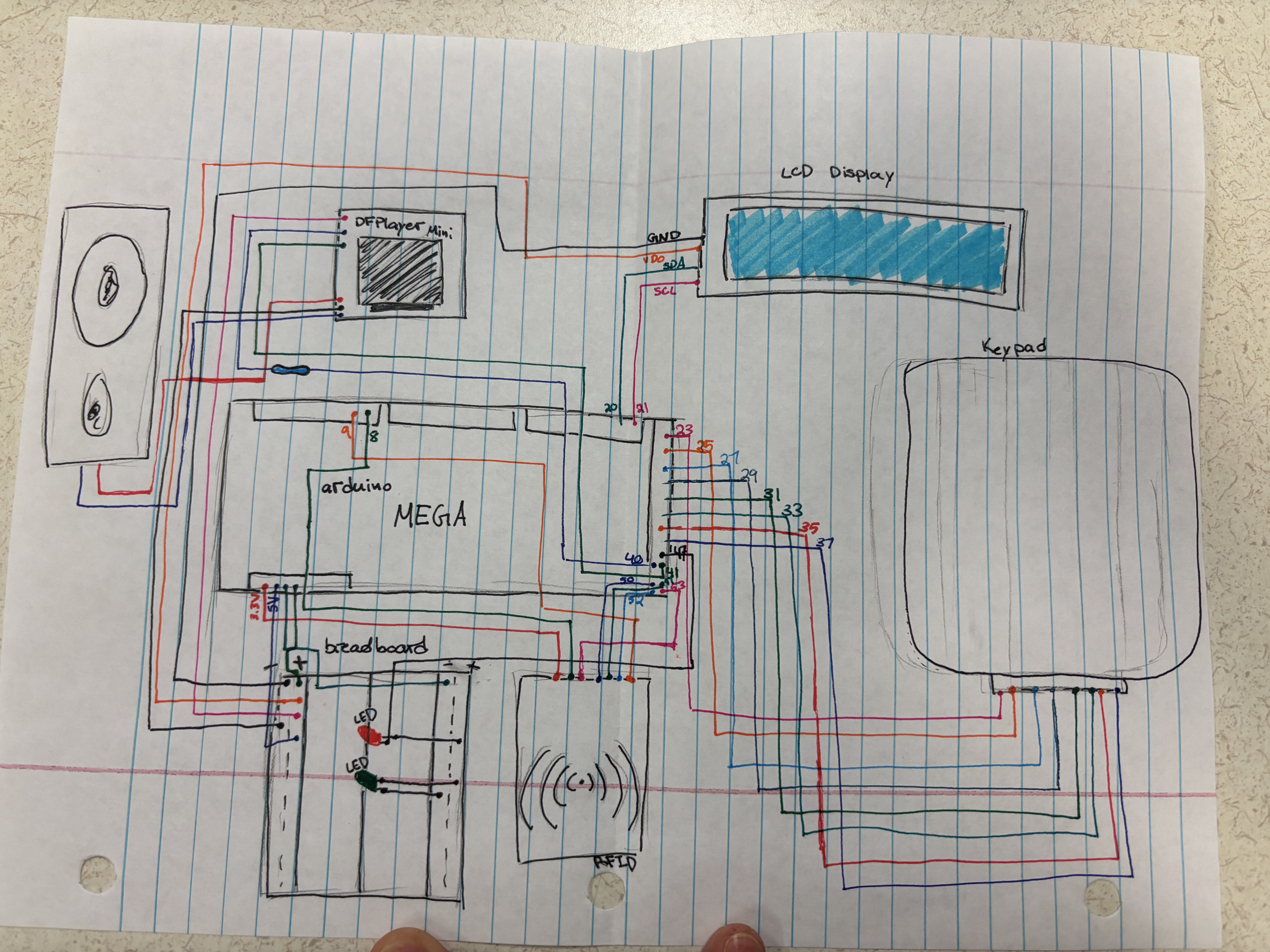

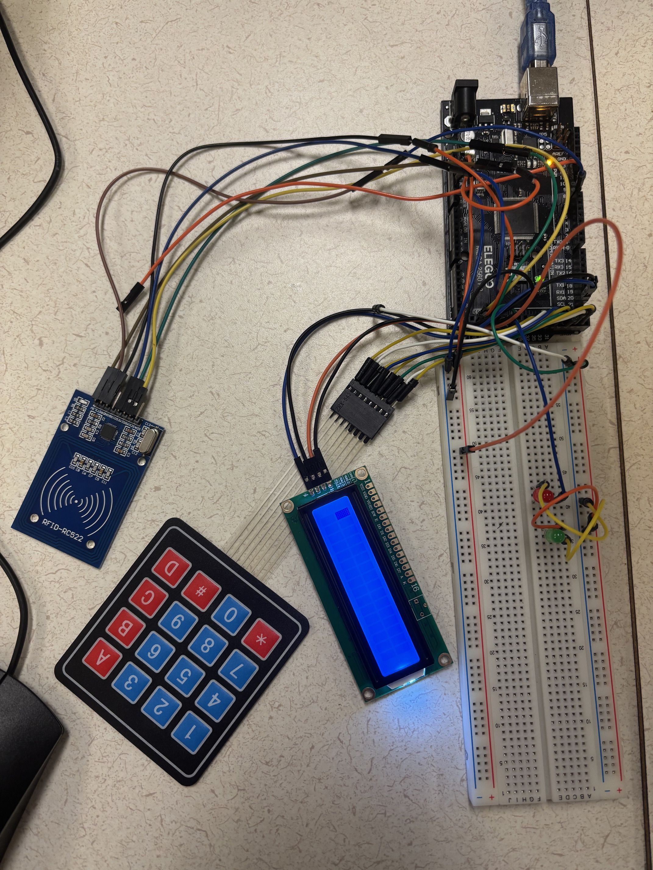

Hello, I have previously made a post about a project I'm creating for school using arduinos and have run into another issue that I cannot solve. My final project will be a jukebox, but for now, I want to make an enter key using a keypad, LCD, and Mega. The idea is that after entering a certain set of numbers (such as 123) and using the enter function to play a certain song, but for now, I just want the LCD to clear and display the letter 'a'. I cannot figure out how to make an enter key for a singular input and have tried using multiple variations of case statements and if statements.
Below is a diagram of my setup, an image of my setup, and my current code. Any help would be appreciated. Thank you!
