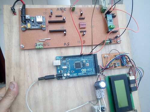

I was referring to the wiring you described in your post! You wrote you connect the adapter to RX/TX and not to RX1/TX1.
OK. Here is a pic.
The pic below is the prototype.
The RS485 module is visible on the right. Wires can be seen to be linking to the Arduino Mega.
pylon:
The cable length is not important here as RS-485 is find for several hundred meters. But the connection of the RJ-45 connector to the "block" connector (I guess that's a screw terminal) is of interest. Try to describe that connection or make and post pictures of it. You don't have to connect GND to the GND on the Arduino side (I recommend against doing that) but it's important to connect A and B correctly.
You have guessed correctly. The block (aka screw terminal) can be seen in the pic above in detail. It is also visible in the pic of the prototype pasted just above.
The two wires going coming from the block connector and going underneath the RS485 module are the A and B of the RS485. I have A and B marked carefully on the veroboard so that I do not mess up. In any case, the system works with the emulator software flawlessly so the connections etc. are not an issue, I think.
I have another block connector for GND, but I am not using it. The system was working with the computer running the emulator software without using the GND wire. So I figured there was no need to connect the GND wire.
pylon:
That's for an ESP8266 which is a 3V3 device. The Mega you're using is a 5V device. Did you respect that?
Infact Yes. If you look at the pic of the prototype you can see the red block in the center. That is the level converter, with its picture.
My original plan was to implement it on ESP8266. The picture of the prototype shows the parallel rails where the ESP is to be installed. However initial attempts with the ESP were not successful due to my lack of capacity. So I changed tack and am now pursuing this course.

I'm using the MAX485 based adapter purchased from:
https://hallroad.org/components/sensors-and-sensor-modules/max485-rs485-transceiver-module-in-pakistan/
This is the circuit.
These modules are of low quality and thus cheap. I therefore resoldered all the joints. I have two pieces and both work when the modbustools software is running.
To conclude.
  1. My prototype works with the modbustools software using the RS485 to USB adapter on the computer side, (linked below), using the ModbusMaster.h Library.
https://hallroad.org/components/development-boards-kits-and-diy/usb-to-rs485-ttl-serial-converter-in-pakistan-en/
  1. The o/p from the charge controller can be easily seen on the modbustools software using EPSOLAR supplied cable. This cable has a CH340 attachment at its USB end.
Logically therefore I conclude that:
a. No problem due to the CC
b. No problem due to the <ModbusMaster.h> library.
The only thing is the Cable.
What do you say.

azhaque:
azhaque
Changed the Cable.
Didn't work.
azhaque
  2. The o/p from the charge controller can be easily seen on the modbustools software using EPSOLAR supplied cable. This cable has a CH340 attachment at its USB end.
What you didn't test is that the connections between your prototype and the charge controller works. Try to connect the charge controller to the prototype and the prototype to the PC as you did in the above tests but don't power the prototype. That setup has a superfluous terminal resistor but should work theoretically. Then use your PC software to request data from the charge controller.
pylon:
EUREKA. It works.
This morning I removed the 120 Ohm resistor to see whether it was causing loading. The change didn't effect the working.
Out of a whim I just reversed the A & B wires and it started to work.
The problem was that the modbus register data ( http://www.solar-elektro.cz/data/dokumenty/1733_modbus_protocol.pdf ) has, on its last page the pinouts of the RJ45 connector on the charge controller. There A is shown as connected to pins 3, 4 and B to 5,6 respectively. THIS IS A MISSPRINT. It is its opposite i.e. 3,4-->B, 5,6-->A.
Will post video of the working prototype shortly.
Thanks everyone for their inputs.
Now to give the data to ESP8266 and put it on the Net.
Regards and Good wishes all round.
