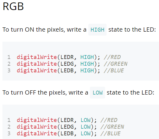

This tutorial has an error in RGB pixel control:
docs.arduino.cc/tutorials/nano-33-ble-sense-rev2/cheat-sheet
The tutorial has:
But this code running on my BLE Sense Rev 2 shows that logic LOW turns ON the LED pixels.
  // no setup required
  // turn all LED pixels ON
  digitalWrite(LEDR, LOW); //RED
  digitalWrite(LEDG, LOW); //GREEN
  digitalWrite(LEDB, LOW); //BLUE
  while(1);

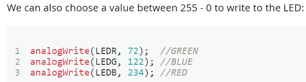

Also, while not an errata, when using analogWrite, a 255 value turns a pixel OFF and a 0 value turns a pixel ON. Not an error in the tutorial, just counter-intuitive.

That is nothing to do with the code and everything to do with how your LEDs are wired up.
So shows us a schematic of what you have and maybe we could tell you where you are misunderstanding things.

My point in posting this is that the tutorial is in error in stating the that digitalWrite(LEDR, HIGH); turns the LED pixel on. Rather it is digitalWrite(LEDR, LOW); which turns the pixel on. The logic is inverted relative to the text.
The schematic is the standard, unaltered, BLE Sense Rev 2 board. The LED pixels are on the board. The tutorial is for the BLE Sense Rev 2 board. The point in posting is that the tutorial has a logic error.
I expected the posted code snippet in the tutorial for the BLE Sense Rev 2 board to work as stated. I did not expect the logic error. Hence I was sharing this observation.

Ok, but the RGBLED are "onboard" to the Arduino Nano 33 BLE Sense 2.
Nano 33 BLE Sense Rev 2-schematics.pdf (1.4 MB)
Here is the BLE Sense Rev 2 schematic. Thank you for your patience.
I see from the schematic that the common leg is +3V3 for DL3.
So that's the technical reason why a logic LOW turns on the pixels.
