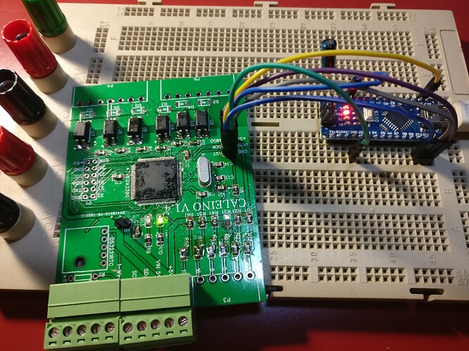

Hi there, I'm working on a project to automate my heating system. I have asked several questions here: Arduino Mega on PCB - General Electronics - Arduino Forum and here: Best system for heating automation - General Electronics - Arduino Forum
The situation is that I have assembled the PCB, I've made a basic checking consisting on making sure that all the VCC and GND pins on the Atmega2560 are corectly connected. I'm using an Arduino nano to burn the bootloader.
I've turned on verbose to see the full problem:

Could it be something related to the crystal? I don't understand much from that info, but it seems to me that something is not correct.
I attach photos of the PCB and the connection with the Nano just in case.
PS: now that I'm seeing the images on the computer I've decided to start clening the board :slight_smile:

I've retried and something has changes. Now on device signature it says:
avrdude: Device signature = 0xffffff (probably .avr8x_mega) (retrying)
How does he "probably" know it's this board?
Wow, by just changing the capacitor of reset pin (In arduino Nano there are two, I thought they did the same) we have made a small step:

It gets the device signature but it doesen't match with an Arduino Mega :o
Have you tested the Arduiono Nano as ISP, on another board, so you are sure its working ?
Give the board a clean.
srnet:
Yes, on an Arduino Uno.
The results are inconsistent. Sometimes the signature is all 0's, sometimes all 1's and sometimes signature that seems right but doesen't mactch an arduino Mega.
srnet:
Done :slight_smile:
I have seen similar behaviour, random IDs, when the wiring was a bit excesssive. One programmer that normally then works is the Pololu one, you can slow it right down.
Myself I would have attempted to program the Mega when it was the only component on the board, plus the decoupling capacitors. Even the crystal should not be needed (initially) if its a factory fresh Mega.
Thanks.
I've followed your advice and unsoldered all the compoenents that were directly connected top the chip except for the bypass capacitors and the reset circuit. I have also unsoldered the crystal with the same results. The board is not recognised.
One detail though:
I have a Nano and a Uno. The Nano has the old bootloader. So I've decided just to make sure I am trying to burn the bootloader properly to burn a bootloader from the Uno into the nano. The results are similar:
