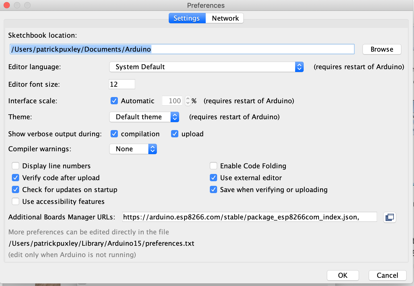

I am posting here because of a similar problem but without being resolved by the above solution. I have looked at many posts on this subject but so far have failed to resolve my particular issue
Same compile error for two different ESP8266 boards
On an imac running Mojave 10.14.6
Removed Arduino15 in its entirety
Deleted everything I could see "arduino"
Reloaded Latest IDE 1.18.12
Added additional boards with https://arduino.esp8266.com/stable/package_esp8266com_index.json
Boards showing, Port showing correctly
IDE working correctly with Pro Mini running various sketches
Tried with both a Wemos D1 Mini and ESP-01S
Tried both the above on a Windows Laptop and both will compile and run Arduino using same breadboard setup and same USB leads
Have checked the Arduino15 package at packages\esp8266\hardware\esp8266 and I have only one folder 2.6.3, the latest ESP8266 package .
I am concluding from the above there is something corrupted in the way the IDE has loaded on the Mac because my attempts at a complete removal have failed.
I hope I have included enough information.
Please can anyone help?

fork/exec /Users/patrickpuxley/Library/Arduino15/packages/esp8266/tools/
python3/3.7.2-post1/python3: no such file or directory
That is a completely different error. The problem is the ESP8266 platform has a tool dependency on Python 3, but rather than installing a dedicated copy of Python 3 with the package, the ESP8266 platform developers assume you have Python 3 already installed at /usr/local/bin/python3. /Users/patrickpuxley/Library/Arduino15/packages/esp8266/tools/
python3/3.7.2-post1/python3 is just a symlink to that location. So either you have Python 3 installed somewhere else, like /usr/bin/python3, or maybe you don't have Python 3 installed at all. If the former, you need to modify the symlink, as described here. If the latter, you need to install Python (and possibly modify the symlink as well if it was installed to a location other than /usr/local/bin/python3.
More information:
Thank you for your response. Firstly I have just within the last couple of minutes got it running. I did another complete uninstall, (well, as complete as I know how). Then reinstalled and in desperation thought I would try an earlier version of the ESP8266 community when I installed it on the boards manager. And it worked. I can now run simple sketches on both. I then updated to the latest version and it still works
I still get the invalid library error, but will see what happens when I try to run more complicated sketches.
So, Im sorted for the time being thank you
