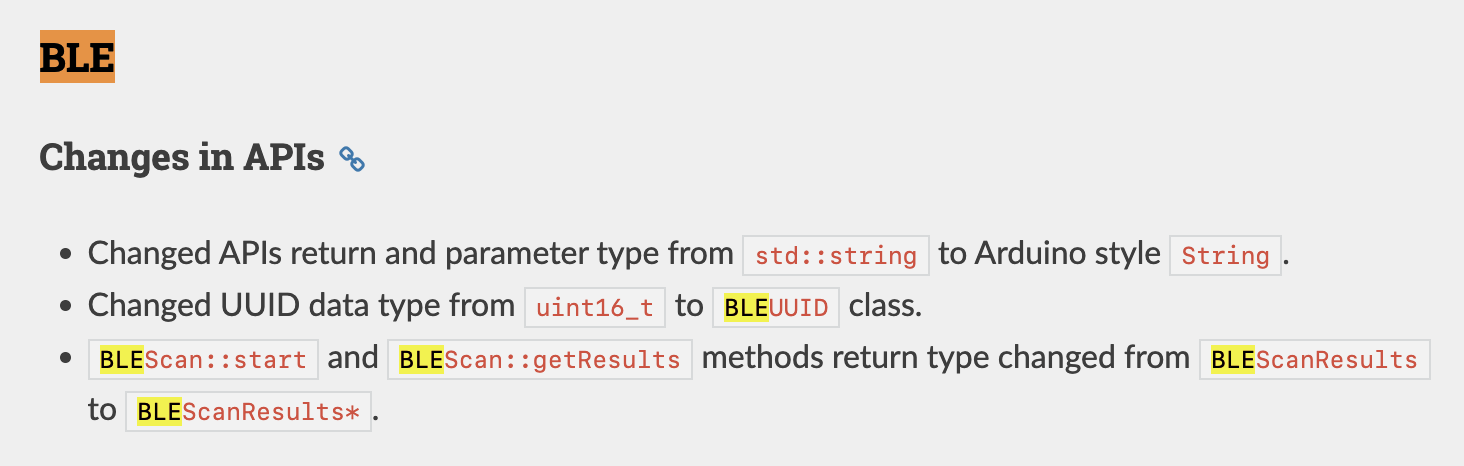

If it was my problem, I would look in the Tools menu; something is set wrong.
Well, uploading to the esp32 without code works fine. As soon as i include the library it doesnt upload.
On a different post i saw something about the library wanting an older version of the core, and to change some lines of code in the library. Though it was for a different library

Where is the Library, I can't help if I can't access it.
HOWEVER, since it's Bluetooth, revert your esp32 by Espressif bords entry back to 2.0.17. The reason why that is required is in the document called something like Migration from 2.x to 3.0. There are breaking changes and BLE is impacted.
BUT I can't test to be sure since I don't know where the BleKeyboard library is.
@domkasus1 Notice that the first error is in the Library code, that is the clue that should have made you check the Migration Document.
Here is the evidence. First pic shows it's in the library code and is to do with String, second pic is the Migration document pointing out the change in 3.x, so you need to change the level to 2.0.17. Since I don't have the library, I can't test but I am fairly certain that is the problem. Remember, no more updates after you back level until the 3.x code is fixed. You could also try using a daily build but then you might pick up another bug. I would just back level. Remember, NOT library, board, and not Arduino, Espressif.
