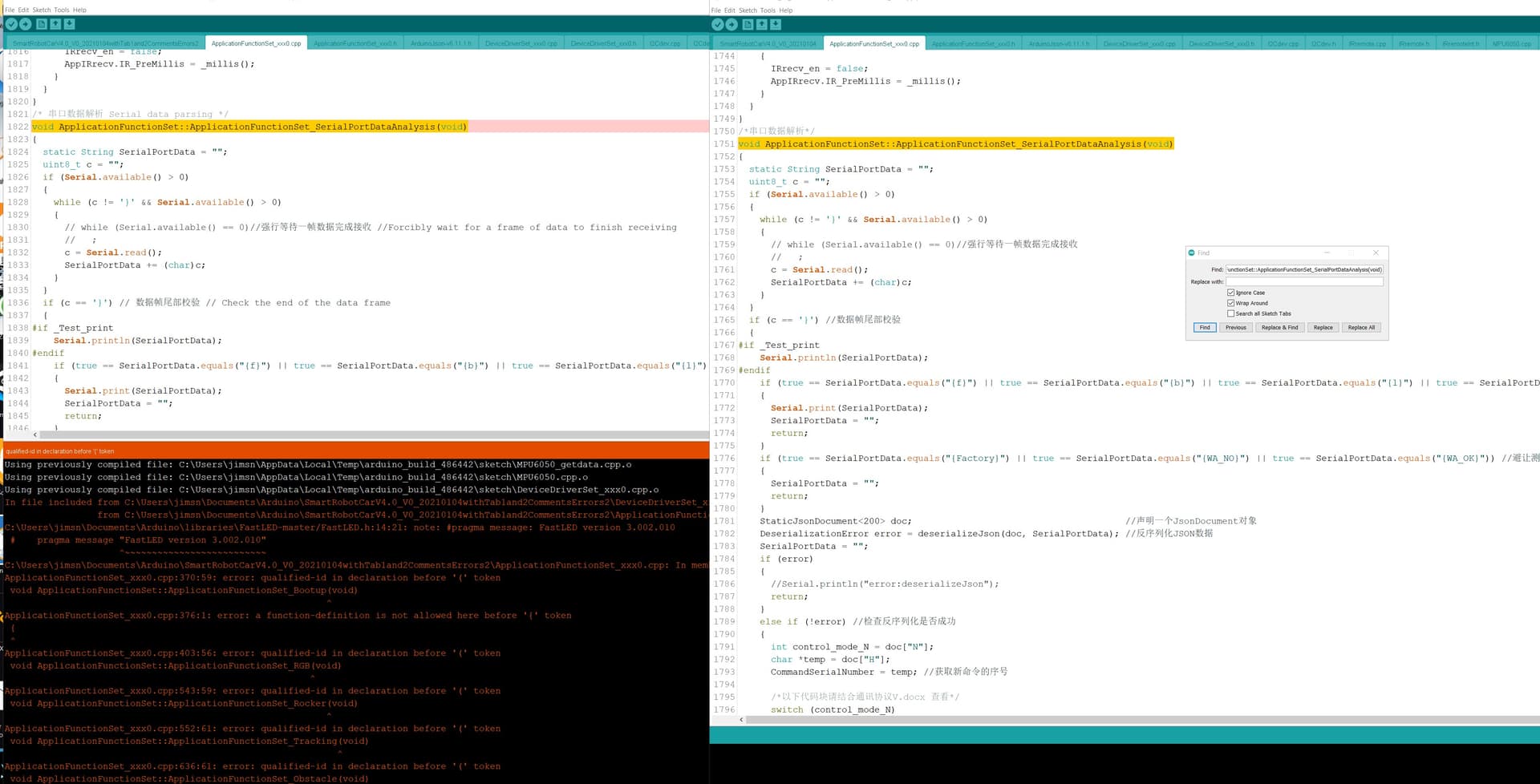

Error: qualified-id in declaration before '(' token
I'm not experienced at programming, but I've been using Google Translate to update the Chinese comments, and add English equivalents in this vendor's massive code base and created a problem I can't find.. I wasn't intending to change ANY actual Arduino code, but apparently have. The question is where? Most of my new comments compiled without error since they were ignored in lines starting with "//" or were placed within "/* new comment here */ " The screen on the left is the new sketch that starts it's 1st errors with the new comments added ( and now fails) and the one on the right is unmodified and will compile with zero errors.. I have spent a pot of time truing to find the root source(s) of the problem but basically don't understand what the errors really mean has gone wrong or where.. I look at the 1st lines flagged in the text in error and the 1st line highlighted in RED some 1200 lines later and careful comparison so far shows no spot where I accidentally added or deleted a "(" or a "{" .. so any advice on how to resolve this would help a lot.. Thanks in advance jimS
Post code, not pictures.
Why does this still need to be said?
The code is massive, do you want the error code(s) or the source .ino or both and how much of it?
To answer: I was hoping a simple .jpg would clarify the limited scope of my query,
I'm on a phone ; a "simple JPEG" is illegible without a magnifier the size of Saturn.
Ok fair enough..
Mostly I have been looking for a missing ")" or imbalanced pair of "{ / }" braces starting here at line 370, but also near the highlighted red line 1822 ..
should I copy paste all that here? or just say 10 lines of it in these two areas.. Main thing I'd like to know is what might be causing this error since I don't understand what it means.
C:\Users\jimsn\Documents\Arduino\SmartRobotCarV4.0_V0_20210104withTab1and2CommentsErrors2\ApplicationFunctionSet_xxx0.cpp: In member function 'void ApplicationFunctionSet::ApplicationFunctionSet_SensorDataUpdate()':
ApplicationFunctionSet_xxx0.cpp:370:59: error: qualified-id in declaration before '(' token
 void ApplicationFunctionSet::ApplicationFunctionSet_Bootup(void)
ApplicationFunctionSet_xxx0.cpp:376:1: error: a function-definition is not allowed here before '{' token
That is saying:
In the file ApplicationFunctionSet_xxx0.cpp
you have a function called:
..._SensorDataUpdate
and inside that functon declaration you have a line (line 307) that says: "void ..._Bootup(void)
The compiler sees that you are trying to declare the '..._Bootup' function INSIDE the '..._SensorDataUpdate' function, and that is not valid C++. Usually this means you have an extra '{' or missing '}' in the '..._SensorDataUpdate' function declaration.
The compiler emphasizes the nature of the error with a further message:
"ApplicationFunctionSet_xxx0.cpp:376:1: error: a function-definition is not allowed here before '{' token"

I finally got the bugs out of the 2nd of 16 Tabs worth of .ino code.. I'll proceed with translating and updating the rest of them later but I'm back in a state where I can upload and successfully run the robot again.. May I ask a couple noob questions before I go? and mark this one as solved..
1.) this massive code is broken up logically into Tabbed sections and each is somehow linked to the code in other 15 sections. It all seems to compile together nicely, but I'm curious how are these separate tabs created. Seems like each time I create a new sketch it all lives under one tab.
2.) Is there as reference somewhere on how to translate these wild and woolie Compiler error notices? I'm assuming you should always start at the top and work down thru them, but find it odd that the 1st ones aren't often highlighted with a red line.. that red flag in my case was on a line thousand lines of code later. Yet most of what needed to be fixed was way above that flagged line..
BTW one of the issues was I did not realize the compiler will get confused if you happen to put two comments together like this as I was doing: " /* comment one / / comment two / you live and learn..btw: comment two reads "/ comment two /" but the editor here strips out the second "/" I suppose for a reason.. :stuck_out_tongue_winking_eye: :yum:

Common compiler errors caused by mismatched brackets:
"does not name a type" or
"expected declaration before" or
"expected unqualified-id before" or
"expected initializer before" or
"expected constructor, destructor, or type conversion before '(' token"
Usually means you forgot a '{' or put in an extra '}' in the previous function. Since all of the open brackets have been closed, the compiler is looking for further global declarations (variables or functions). If it finds something that looks like executable code instead of a global declaration it emits an error. Make sure that the brackets in the preceding function are in matching pairs '{' followed by '}'.
"a function-definition is not allowed here before '{' token"
(can cause: "'functionName' was not declared in this scope")
Usually means you forgot a '}' or put in an extra '{' in the previous function. Since a set of brackets has not been closed yet the compiler is looking for more code to put in the function. You can't declare a function inside a function so if the compiler finds a function declaration it emits an error. Make sure that the brackets in the preceding function are in matching pairs '{' followed by '}'.
"expected '}' at end of input"
Usually means you forgot a '}' or put in an extra '{' in the last function in the sketch. Since a set of brackets has not been closed yet, the compiler is looking for more code to put in the function. When it hits the end of the file instead, it emits an error. Make sure that the brackets in the last function are in matching pairs '{' followed by '}'.
"expected primary-expression before '}' token"
Usually means you have an incomplete statement before a '}'. The block statement (between '{' and matching '}') can only contain complete statements. Complete statements always end with ';' (or '}' for a block statement).
