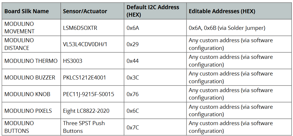

While I understand that the target group of the Plug-and-Make-Kit is not supposed to deal with I2C addresses, the documents still should give the correct data.
When checking the kit that I received in July, using Nick Gammon's Scanner (and an UNO R3 plus level shifters), the result was only ABX00101, 102 and 103 are listed correctly in the AKX00069-datasheet.pdf, page 14.
Buzzer (108) is 0x1E instead of 0x3C,
Knob (107) is 0x3A instead of 0x76,
Pixels (109) is 0x36 instead of 0x6C,
Buttons (110) is 0x3E instead of 07C.
Using the address 0x1E, I could produce some sound by sending Wire1.write(data, 8); to the buzzer.

Note that the addresses that you mention are multiplied by 2 (or shifted one place to the left). The address bits are the 7 most significant bits, the least significant bit is the R/W bit.
If referring to the address with the shifted value is correct or not is debatable; I do not know what wisdom is from that perspective.

It looks like there is an off by 2x error, except for one of the addresses
0x1E x 2 = 0x3C
0x3A x 2 = 0x74 (not 0x76?)
0x36 x 2 = 0x6C
0x3E x 2 = 0x7C
It might be to do with the explanation here:
No it is not an error, but your observation is correct.
The lower ones are the actual addresses, the higher values are shifted one bit as the I2C protocol adds a modus bit - read or write bit - to it.
That is the reason why one normally never see I2C addresses above 0x7F (decimal 127).
OK there exists a 10 bit addressing scheme too, but these are rare in Arduino land
Sorry, I didn't mean an error in the spec. I meant a misunderstanding of what values the code has to use versus the values written in the specification.
I've been caught out like this before. It's what made me notice the factor of x2 difference.

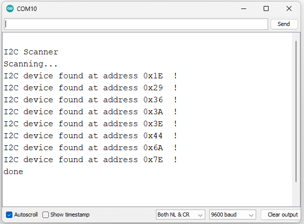

I have repeated Klausj's test, and used an I2C Scanner on the Modulinos of my Plug and Make Kit.
I had all 7 Modulinos connected at the same time, the results were as follows:
I2C Scanner
Scanning...
I2C device found at address 0x1E !
I2C device found at address 0x29 !
I2C device found at address 0x36 !
I2C device found at address 0x3A !
I2C device found at address 0x3E !
I2C device found at address 0x44 !
I2C device found at address 0x6A !
I2C device found at address 0x7E !
done
These results agree with what @Klausj found.
Although 7 devices were connected, 8 addresses were found.

It is the Movement Modulino (LSM6DSOXTR) that is reported as 2 Addresses.
LSM6DSOX datasheet
I2C Scanner - LSM6DSOXTR
