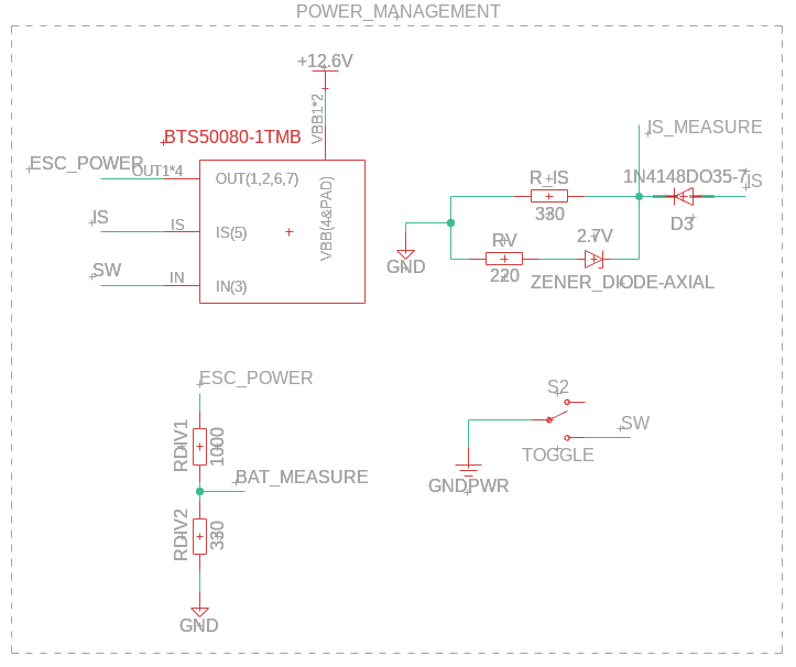

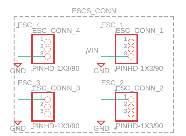

I am assuming you followed standard engineering design practices. Can you post your an annotated schematic showing how you have wired it. Be sure to include all connections, power, ground, and power sources. Links to technical information on the hardware devices is also needed.

Those are the schematics and the datasheets that i think could be useful:
ESC to motor connection:

ESC_CONNS
Signal connections:
ARDUINO_CONNS
(Suspected malfunctional esc connected at D7)
High-side switch connections:
BTS50080 Switch datasheet
Motor informations
