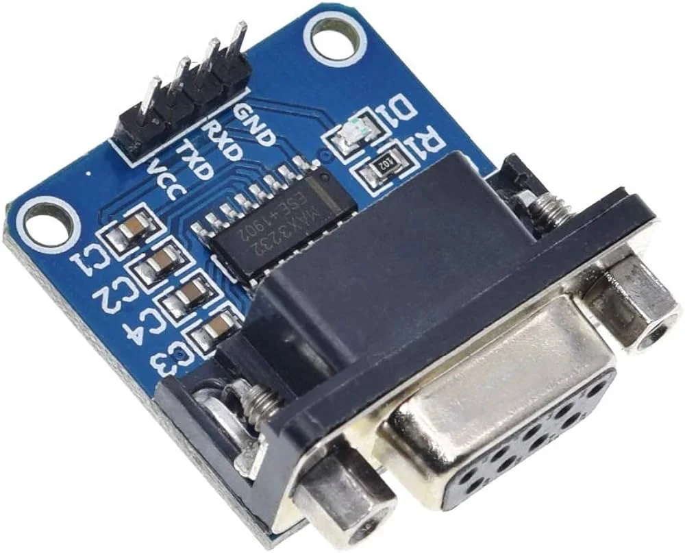

Thanks for your reply, well i am using Rs232-ttl converter. between inverter and esp01
i am connecting the RX of ESP-01 with TX of Rs232-ttl converter. similarly TX of ESP-01 with RX of Rs232-ttl converter to send and receive the commands

It's not level shifter, It's Rs232-ttl converter.

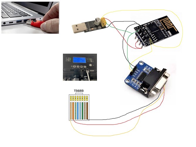

Here is the rough diagram of how things physically working
i am using breadboard after programing the esp-01 . i am using just the RX TX and Power from programmer
After programming GPIO 0 should not be connected to GND anymore.
instead of connecting ESP-RX to the programmer, just connect it to the converter.
Connect TX of the programmer to GPIO 2 of the ESP.
Use Serial1 for the debug and Serial for the connection to the converter.
Please update the drawing and upload the new code, so we can see that you understand correctly or we need to improve on the explanation
Ok as far as connections are concerned here is what i have learnt from your post
but for the program i am still confused can you please guide me about code as per this diagram . i am not good at coding
Eh have you now connected ESP RX to converter RX (instead of TX) ? It's a little hard to tell because you've turned the converter over in the newest version. For the rest that looks fine.

ESP RX is connected to TX of Converter yes i have changed the picture. well many thanks for the code i will try and update you as soon as i get any success. many thanks for the code again
Since RS232 converter board is just a "translator" it might be correct to connect TX to TX and RX to RX.
ok will give it a try
Please add a resistor in between pins on each line to limit the current or you may damage your ESP (and possibly the converter) something like 10K will be fine for slow speeds.
You mean 10K between every connection i.e. between ESP and Programmer as well as ESP to Converter ?
no just between esp & converter TX & RX. Particularly if you are going to start swapping them over ! if two TX lines are connected they may break otherwise. Hopefully not since there would be no reception on the RX line and so no response, but still it may happen.
