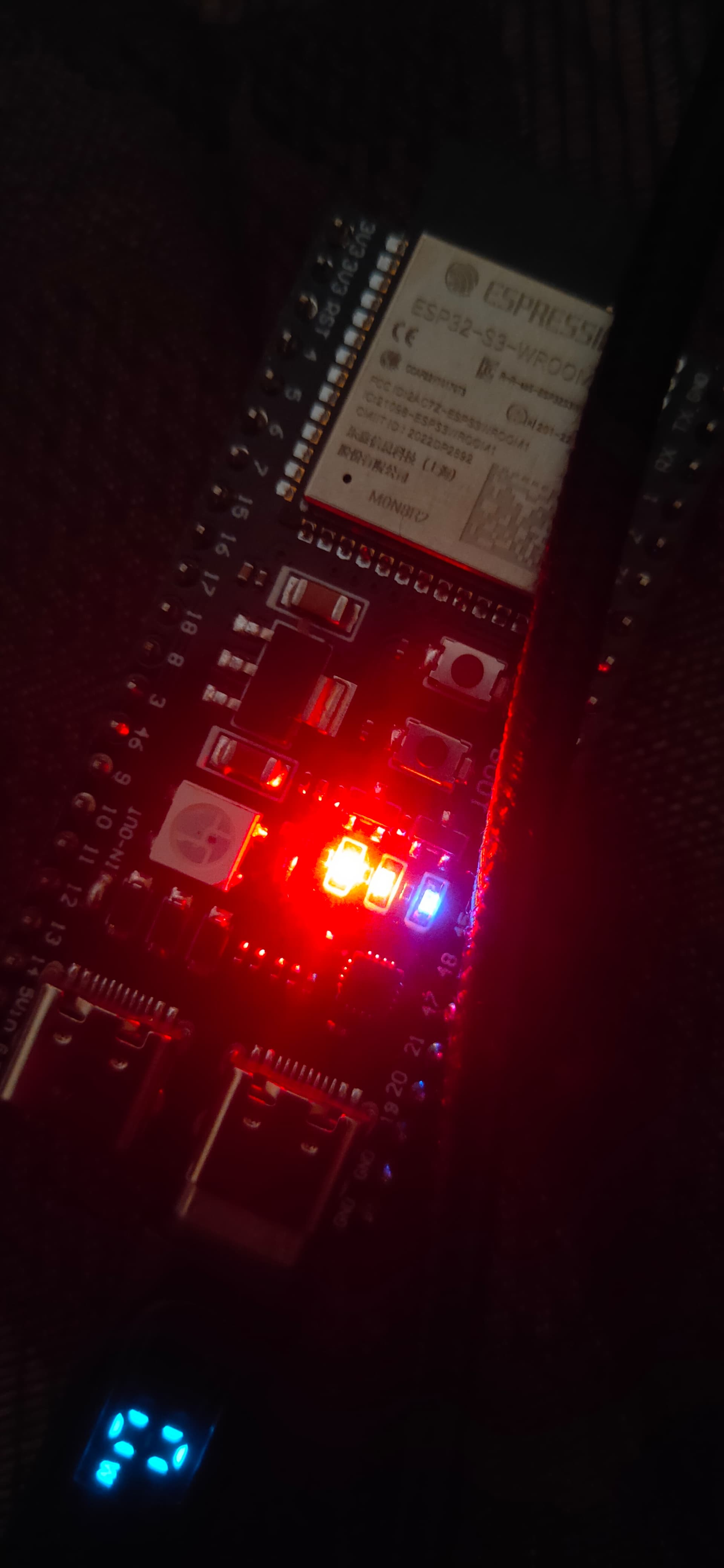

I have a problem when I want to upload a program on my esp32 s3, namely an error
the error is
A fatal error occurred: Failed to connect to ESP32-S3: Invalid packet head (0xE0): Possible serial interference or malfunction.
Failed uploading: uploading error: exit status 2
please I have replaced the cable and pressed the boot button but it still can't work.
Quit clearly from the photograph, you do not have an official Arduino Nano ESP. Yet you posted in the official Arduino Nano ESP forum.
Therefore I have moved you post to a more appropriate place.

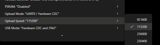

This error might be caused by the board not being able to support the rather high default upload speed. If so, the problem should be fixed by reducing the upload speed, which is configurable via a convenient menu.
Select Tools > Upload Speed > 115200 from the Arduino IDE menus and then try uploading the sketch again, just as you did before. Hopefully this time the upload will be successful. If not, add a reply here on the forum topic to let us know and we'll investigate further.
Optimizing Upload Speed
If the sketch upload no longer failed after reducing the upload speed, you will have determined that the board is not capable of managing uploads at the default 921600 baud, but is capable of them at 115200 baud.
Especially with more complex sketches, the upload will take a significant amount of time at 115200 baud. It is likely that the board is capable of managing uploads at some speed higher than 115200 baud, so it is worth doing some experimentation to determine the maximum speed at which you can reliably upload to the board. You can do this by repeating the "Configure Upload Speed" procedure above, but selecting different speeds each time. Then attempting an upload to see if the new speed is appropriate.
your board looks like a Espressif ESP32-S3-DevKitC-1 or similar
what Tools>Board have you selected? I use "ESP32S3 Dev Module"

I used the board for my esp32 s3 wroom 1. I used the board for my esp32 s3 wroom 1, but it's still not working.

I've tried using other cables up to 3 or 4 cables but it still doesn't work, I've also tried all baudrates and it doesn't work.
But when I hold down the boot button while connecting the error status changes to
A fatal error occurred: Failed to connect to ESP32-S3: No serial data received.
Failed to upload: upload error: exit status 2
are you sure you have the correct COM port?
if you run the Device Manager does COM port appear/disappear as plug/unplug the microcontroller?
if not do you get any message, e.g. "USB device not recognized"
disconnect everything (sensors/relays etc) from the board
try a different USB port
try a different USB cable (some are charge only)
