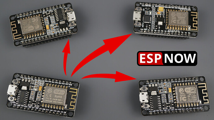

after failing to explain properly the problem i have in my previous thread, now i've made a diagram explaining what i would like to accomplish.
So, i need to read a button state on one ESP8266 device and then send state HIGH or LOW to 4 devices at the same time, based on button's state of the "master" device, LED would turn on or OFF on "Slave" devices.
  1. I do not need any feedback from 4 "slave" devices. They just need to read/get the signal from master and act on it
  2. I need to to capture the signal on all 4 "Slaves" at the same time, if possible
  3. latency of the signal should be minimal, i know real time is not possible but as close as i can get would be perfect.
  4. more than 4 slaves would be ideal but i can also work with only 4
I am not a skilled coder, i can understand most of the code when i see it but i am not able to write this one on my own so i am kindly asking for any directions or instructions, perhaps existing code that i could re-purpose or rework.

thanks "runaway_pancake".
I apologize as i failed to mention that ESP-NOW is not the good options due to significant latency in transmission and due to the fact that i would need to update remote "master" every time i want to add new "slave", with MAC address.
This button is going to be presses every second for a specific time period of 100 or 200 ms, so latency with ESP-NOW being 30-50ms is not an option.
I already have a working prototype with 5ms latency and using softAP but this only allows me to use direct communication 1on1 and i am not able to add more slaves.

Latency?
I use ESP-Now in a scheme replacing my garage door remote control with.
Leading up to that I was low-level testing by blinking an LED and I couldn't tell from latency.
I haven't used the "single xmtr, multiple rcvrs" configuration, if that makes any difference.
