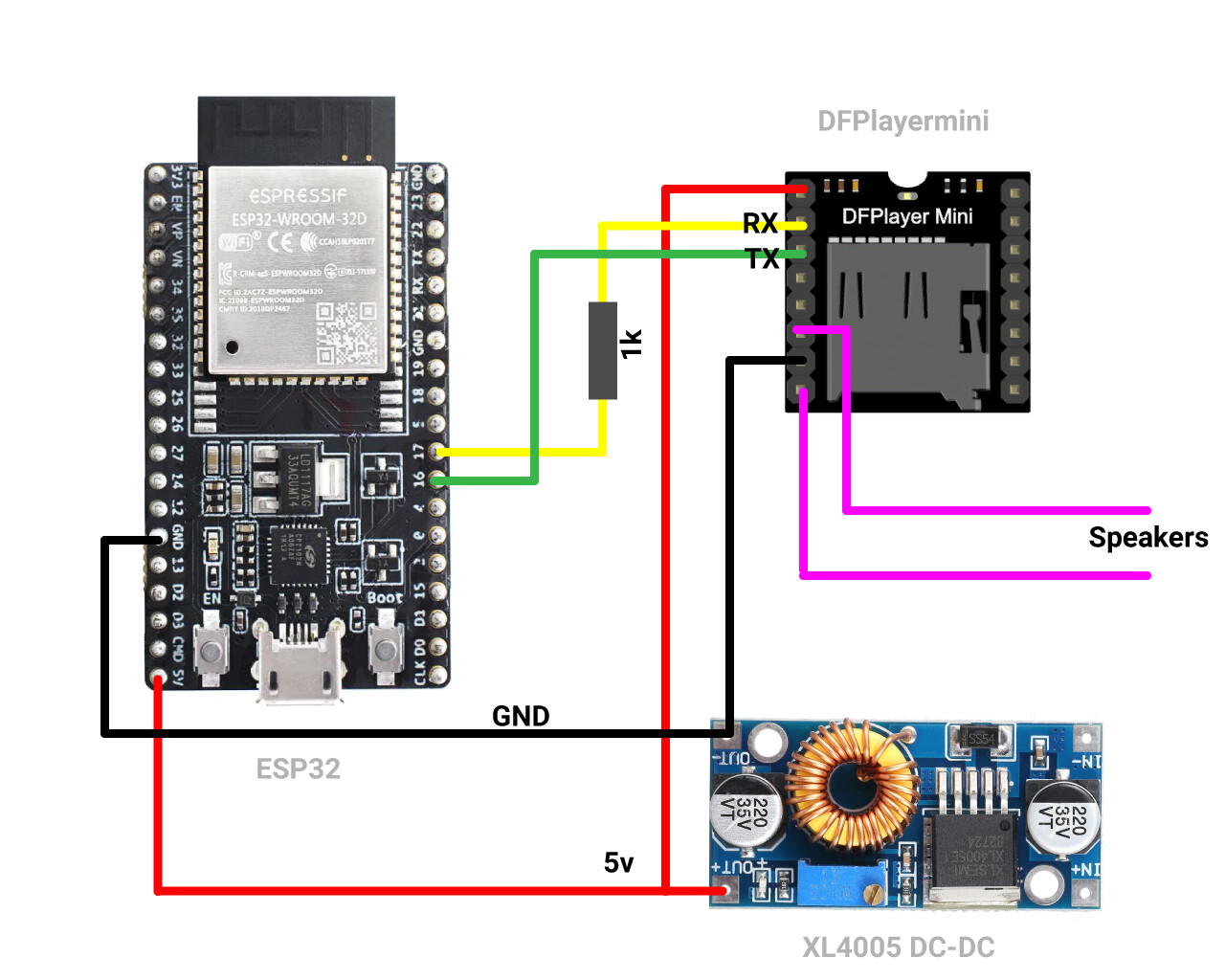

Hello, I am trying to migrate a project that I had with an old arduino board to esp32, but it is not working for me; I test with an esp32 connection example with dfplayermini, but it never connects to serial. I really don't know what I'm doing wrong with the ESP32 board.
My ESP Board is ESP-WROOM-32D:
arduino_board
My diagram
My sample code, for tray connection ESP32 with DFPlayermini

And for last, this is the error that show me the serial monitor:
DFRobot DFPlayer Mini Demo
Initializing DFPlayer ... (May take 3~5 seconds)
0
Unable to begin:
1.Please recheck the connection!
2.Please insert the SD card!
Not connect to DFPlayer mini :slightly_frowning_face:
Thnks for u help
The 1k resistor, in this application, is not necessary.
You have the SoftwareSerial include commented out --
//#include <SoftwareSerial.h>
also this --
//SoftwareSerial mySoftwareSerial(16, 17); // RX, TX

What's the source of the "sketch" you guys are trying to use?
I think they are usingthis one
For narrowing down the problem:
Did you check the MP3-module if it works with some other microcontroller?
Do you have a USB-to-TTL virtual-comport-adapter that you could use for a basic test if the MP3-module is sending anything at all?
Do you have a 24 MHz 8 Ch logic analyser like this
these analyser can record logic-levels and with the software sigrok PulseView you can even analyse the protocol
best regards Stefan

There are three important things about serial interfaces:
different microcontrollers have a different number of hardware interfaces
hardware-interfaces can run on high baudrates
Ardunio Uno only one hardware interface
Arduino Mega has three hardware interfaces
ESP8266 1,5 hardware-interfaces but higher CPU-frequency as an Uno
softwareserial runs on an arduino Uno or nano only at low baudrates
On ESP8266 on medium fast baudrates
ESP32 has two hardware serial interfaces
an ESP32 can also run software serial interfaces at higher baudrates
If you post your new code that you tried and a detailed description what behaviour you got te forum can surely help
best regards Stefan

  Serial.println(F("Initializing DFPlayer ... (May take 3~5 seconds)"));
  if (!myDFPlayer.begin(mySoftwareSerial)) {  //Use softwareSerial to communicate with mp3.
    Serial.println(myDFPlayer.readType(),HEX);
    Serial.println(F("Unable to begin:"));
    Serial.println(F("1.Please recheck the connection!"));
    Serial.println(F("2.Please insert the SD card!"));
    while(true);

Hmmm. . .
Though there is SoftwareSerial for ESP8266
there is NOT for ESP32, because it has 3 UARTs (but the '8266 has 2 1/2, one is TX only). Anyway.
This compiles, but Untested (my ESP32 is in the wash, it's busy right now).
Your test mp3 is called 0001.mp3 (everything on the SD should be 001.mp3, 002.mp3, 0001.mp3, 0002.mp3, 0003.mp3 and so on)
It just starts playing 001.mp3, goes on for 2seconds and starts it over again (and again, . . .)

ESP32, Arduino and 3 hardware serial ports | QuadMeUp
(he has include <HardwareSerial.h>, but that would not Compile while #include"HardwareSerial" did.)
Thank you for looking into that. I will look into serial communication for esp32 and see if I can find something. I ordered a pack of 5 DFplayers I will also try using a different one.
Didn't work ?
PE -
Located another ESP32, but not connected to a player module -
on TeraTerm I see the player INIT stream and then what are PLAY commands.
So, at this point, I'm 'fairly certain' that that should be 'working'.
