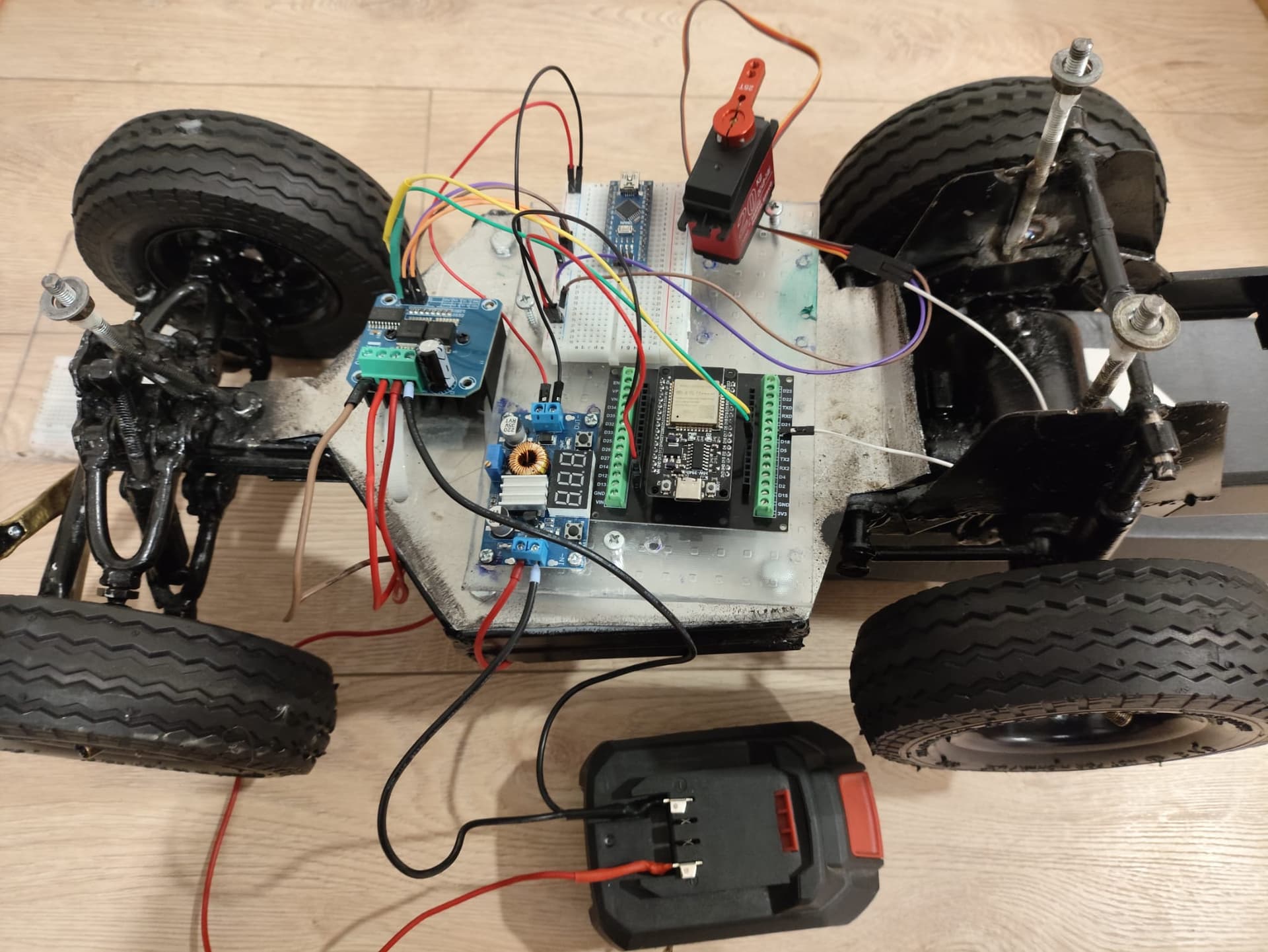

Hi everyone,
I'm working on a Bluetooth-controlled car using an ESP32. The setup includes:
  • One DC motor for traction (connected via BTS7960)
  • One servo motor for steering
I'm using a custom joystick app that sends Bluetooth commands to the ESP32 in the following format:
F50L30 → Forward at 50% speed, turn Left at 30 degrees
B30R20 → Backward at 30% speed, turn Right at 20 degrees
My issues:
  1. The servo doesn’t move – it stays in the center, even when I send L or R commands.
  2. The traction motor sometimes reacts to steering inputs – for example, when I move the joystick for steering, the motor starts turning even though I'm not sending forward/backward commands.
You can check out the full code and setup on my GitHub:
:backhand_index_pointing_right: carro-bluetooth/Controle_ESP32 at main · kv4044/carro-bluetooth · GitHub
I’ve been debugging for a while, but I’m not sure if it’s a logic issue in the code or how I’m handling the serial input. Any help or suggestions would be really appreciated!
Thanks in advance!

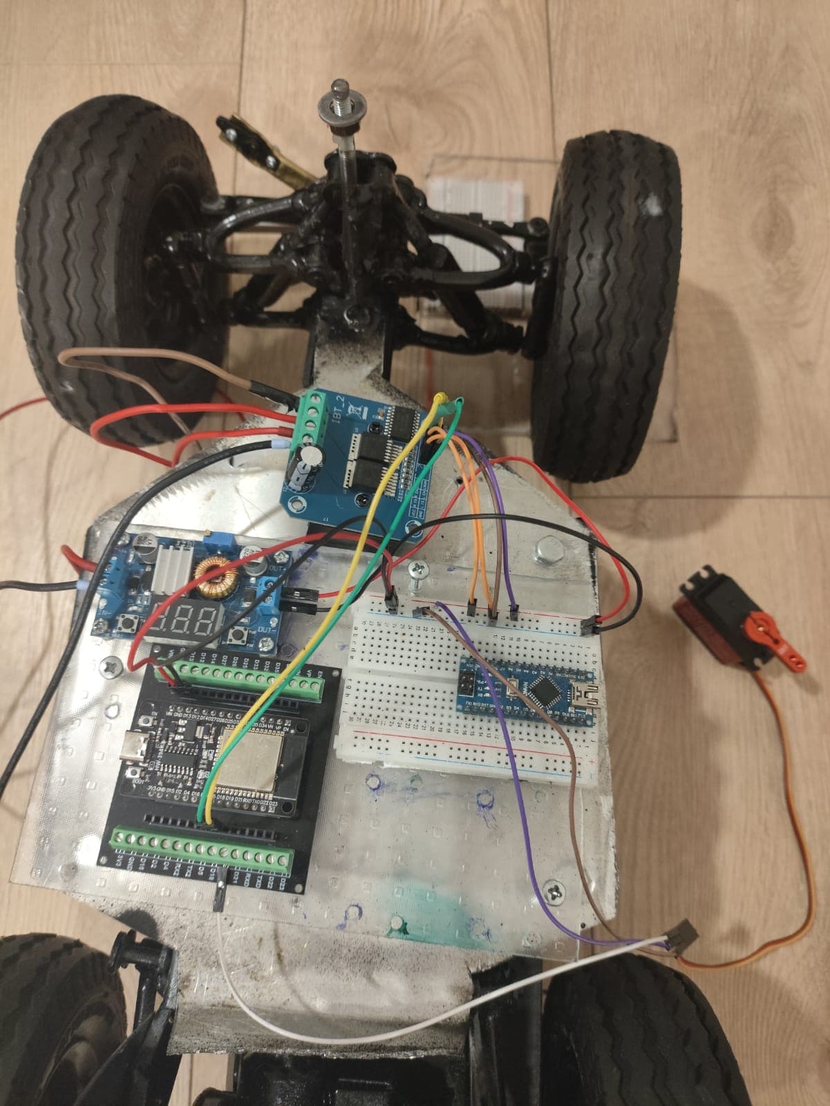

Post a wiring diagram.
How does the servo get power (wiring diagram), and at what level?
Depends on wiring, might be the solderless breadboard failing.
Post code and supply wiring diagram.

Wiring diagram:
The full code:

Thanks for your suggestion! I tested the same servo motor with a different program, and it worked fine. So I believe the issue is not with the servo itself, but something in my current code or setup.
90 degrees is a servo's "home" position when power is applied... (unless the servo is 360 [probably not], and that is its "stop" position). So if "R" or "L" are not arriving... the servo will remain at 90/HOME.
Do you send/receive Upper Case R and Upper Case L?
What is the value of input.substring(4, 6).toInt()? (use Serial.print()) Compare that to the output of the transmit end of the bluetooth connection.
