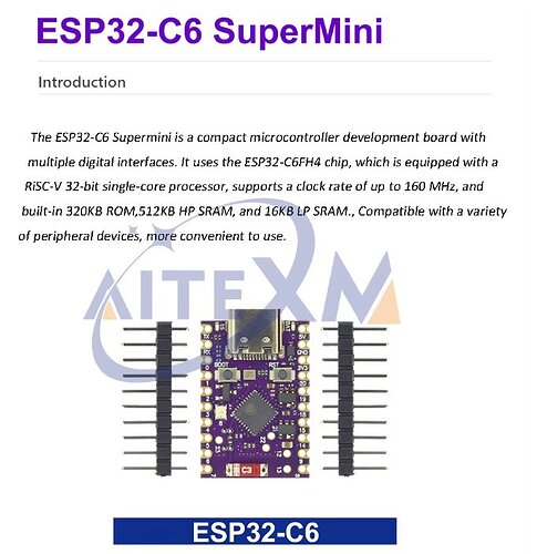

I recently purchased a new ESP32-C6 super mini board.
after compiling a sketch uploading to the processor does not work because the IDE claims a wrong selected board. The error message is just " A fatal error occurred: This chip is ESP32-C6 not ESP32-C3. Wrong chip argument". I am using the IDE 1.8.19 version.
Obviously the IDE detects the right board but ESP32-C6 is not on the list. I tried ESP32-C3 and S3 but no success. Does somebody can give me a hint which board I have to select or do I need to update the IDE ?
ESP32C6 Dev Module
If you don't have that, you need to update Esp32-core.
@kmin thanks for this hint, I updated the ESP-core and then could select the C6 variant.

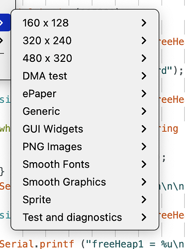

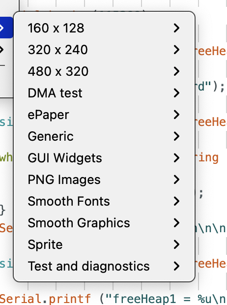

the sketch was Bodmer´s example from the library
That's no help, the rule is to post all code in code tags, see the pinned post.
Which one
I will open another topic for this problem, for now I tried the Adafruit library and this one works
