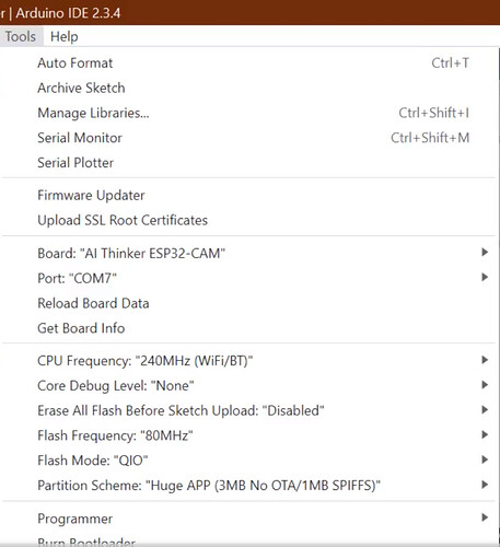

This is how my Tools look like. I'm using the AI Thinker ESP32-CAM board.
As you can see in the image, there is no Upload Speed. I've looked at other forums and I can't find anything that helps. Do any of you have any suggestions for help?

In Arduino IDE 1, then if you had the No Serial Data receive error then reducing to upload speed could make the upload work.
No idea where the upload speed option is hidden in Arduino IDE 2.
